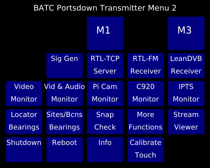

  • Rearranged Menu 2 with 5 "Monitor" buttons. The first enables display of the video input to an EasyCap, but without the audio being played. The image size is 540x432 (3/4 of the captured resolution) to allow display of the complete image whilst keeping the scaling reasonably easy for the RPi processor.
  • The second button displays the EasyCap video and relays the audio to the selected output socket. In this case the image size is 360x288 (1/2 of the captured resolution) as the processor could not cope with any more complex scaling whilst also handling the audio.
  • The third button displays the image from the PiCam. Useful for testing and setting up before transmission.
  • The fourth button displays the image from the C920, but without audio. If you want audio as well, select Comp Vid as the transmit output and select the C920 from the Comp Vid transmit menu.
  • The final button in the row uses omxPlayer to display (and play audio from) any stream sent to the Portsdown on port 10000. This can be used to test IPTS in, and can also be used as a remote display for a second Portsdown with LongMynd receiver in UDP mode. Just remember to change the port number in the LongMynd config. In future, I may replace this player with VLC, but further testing is required first.
