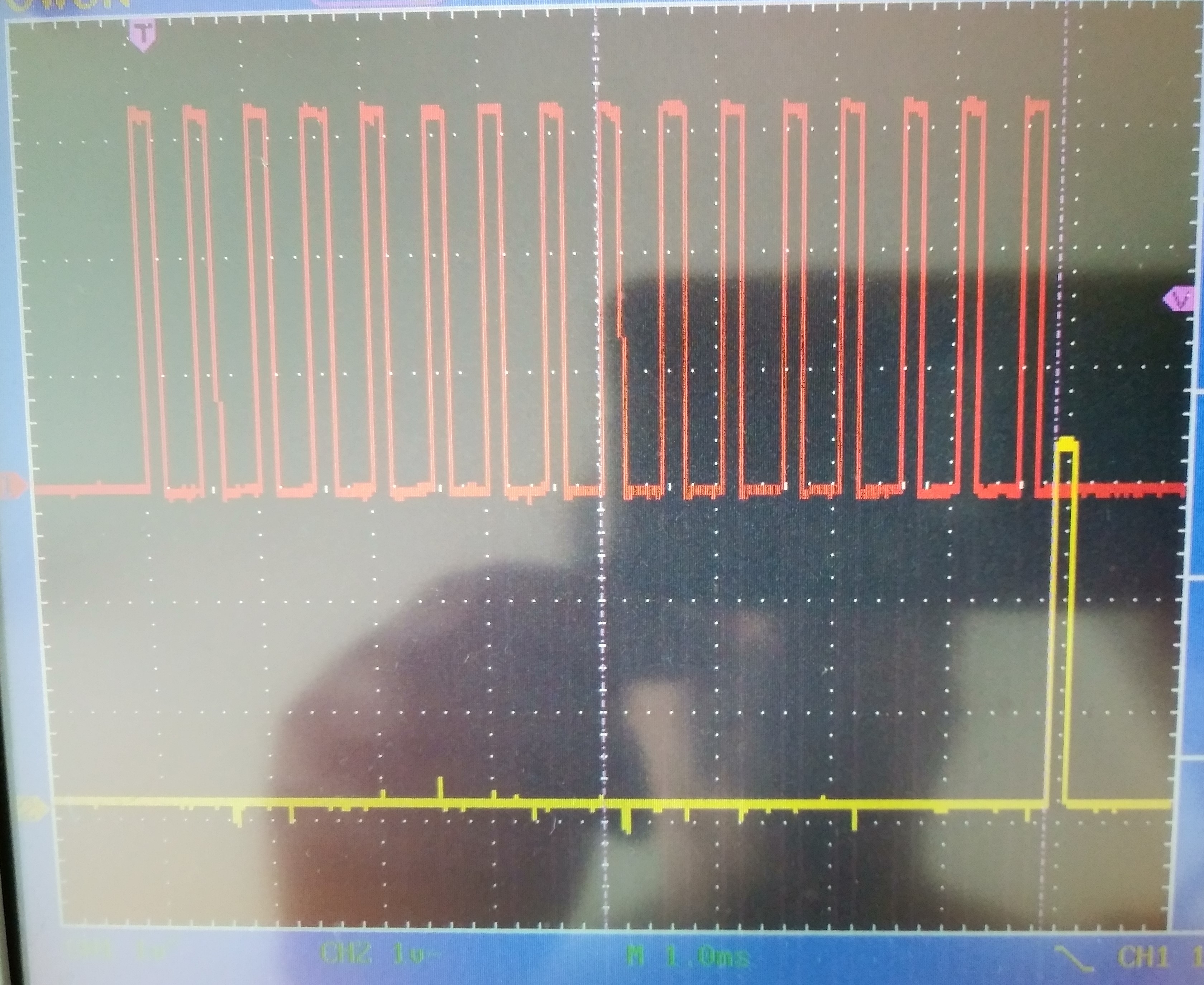

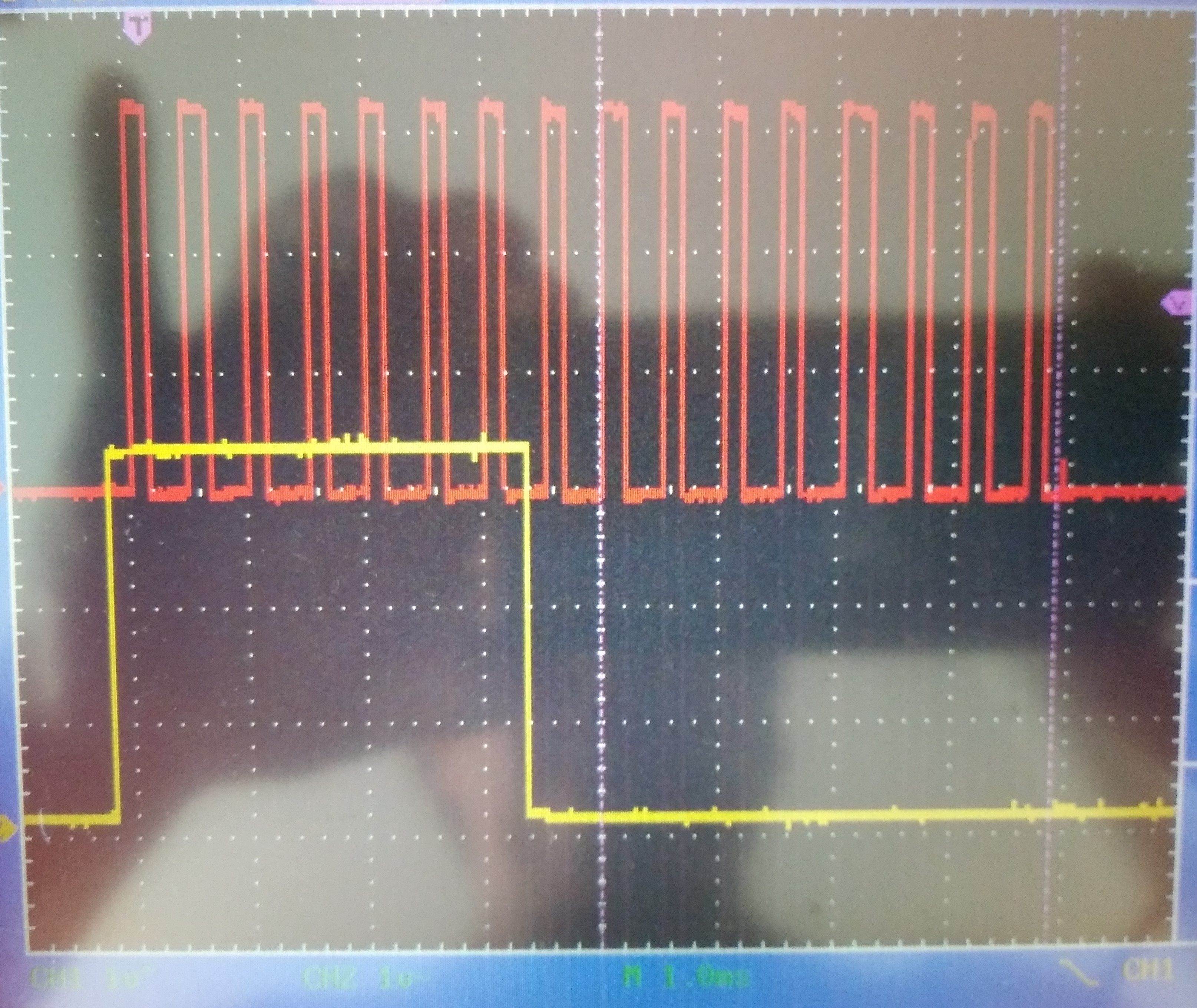

Re: PE43703 Attenuator
Hi Frank,
I have included a couple of oscilloscope screen shots from my PE43703 testing. The first shows data with clock, in this case 7 ones. The second shows the LE with the clock. The LE is easy to miss. The 'scope was triggered on the clock signal, with horizontal time-base set to 1ms/cm and vertical gain set to 1V/cm.
As a preliminary, check first for continuity of wires to pins and and shorts between pins and of course, that the 5V power supply is present.
Jen G4HIZ
Jen G4HIZ
- PE43703_Clock_with_Data_G4HIZ_200412.jpg (1.44 MiB) Viewed 4737 times
- PE43703_Clock_with_LE_G4HIZ_200412.jpg (1.5 MiB) Viewed 4737 times
