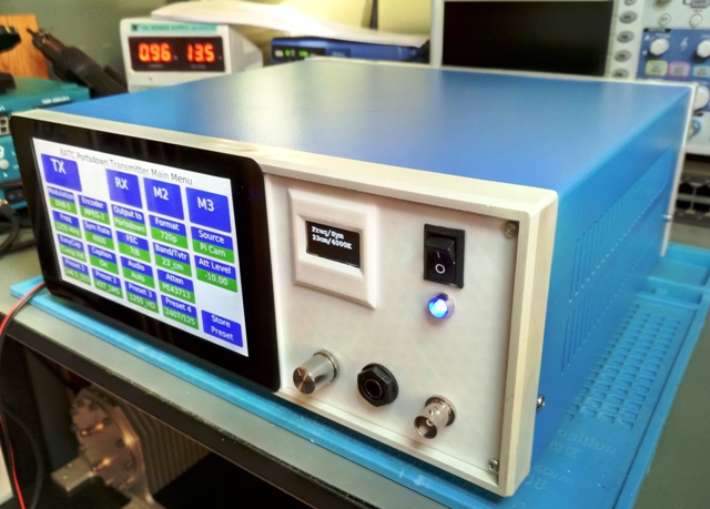

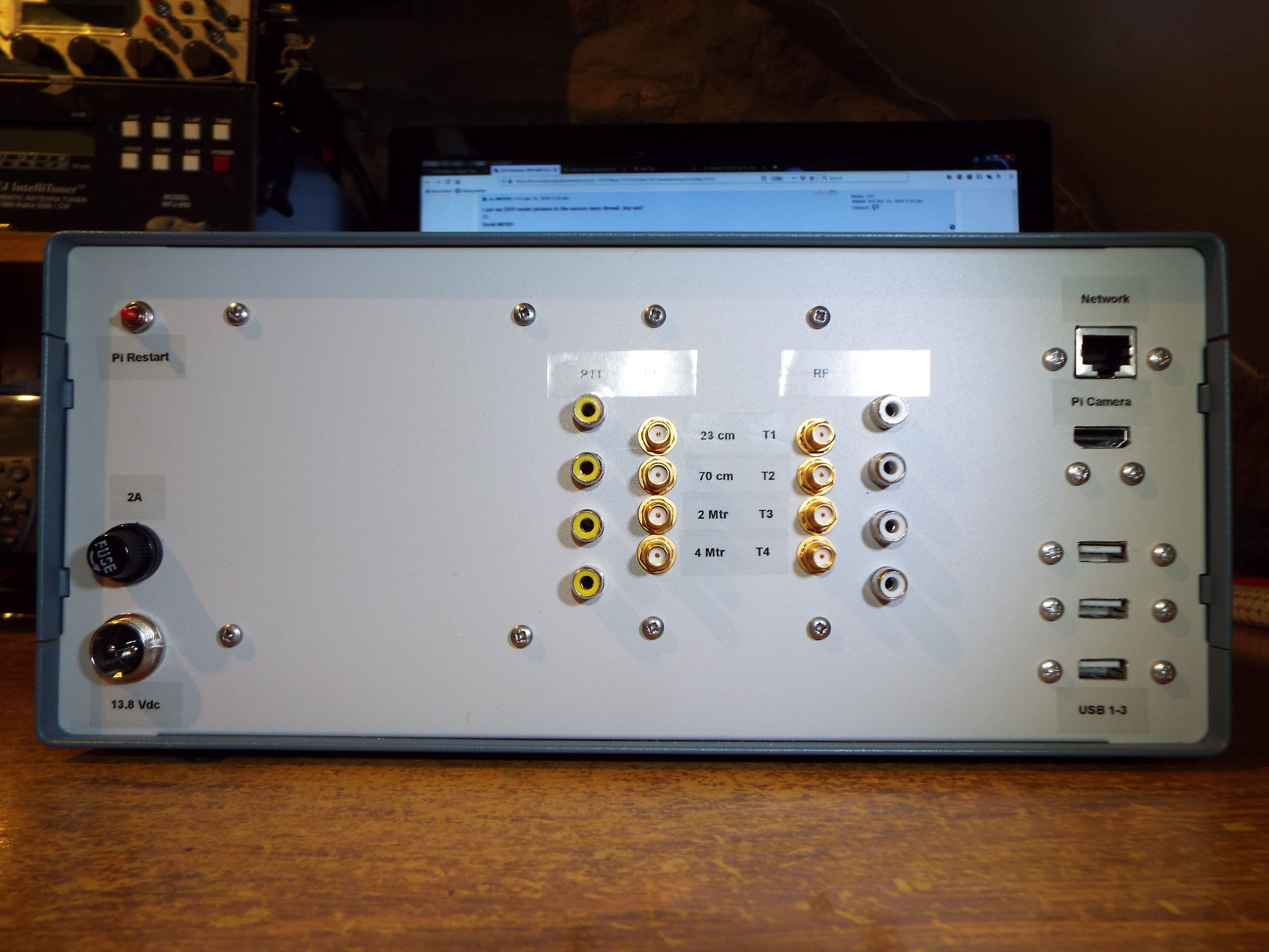

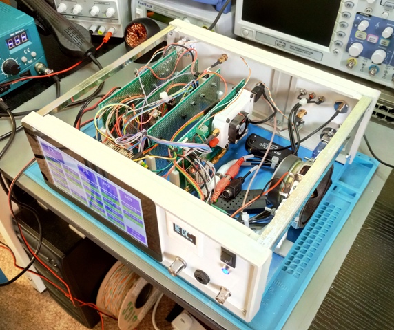

I used the RS 754-5998 which is now discontinued, but the RS 754-6008 is available which is the same but 101mm deeper, which may have been a better choice as more room front to back.

Front View.
Front View.
Rear View.
Rear View.
Inside View.
Inside View.

the bigger case looks perfect. Not a bad price either.
great pics and a stunning build

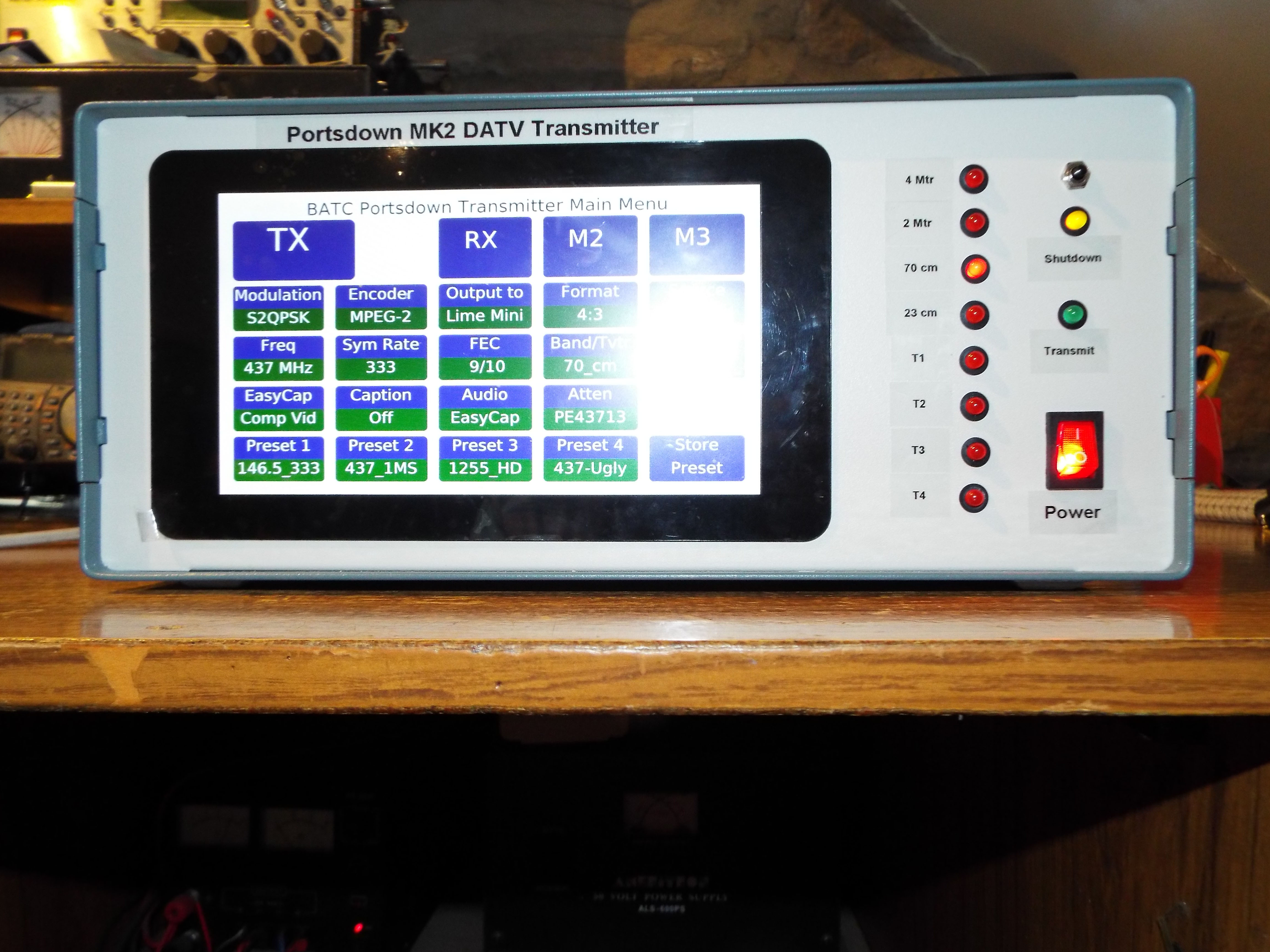

Just to add another option. I used one of the cheaper, Chinese blue boxes. Outer Size: 305 x 282 x 122mm/12 x 11.1 x 4.8inch(L*W*H).
The 7 inch screen fits nicely on the front. I replaced the steel panels that came with the box for 3D printer ones. The steel ones are too difficult for me to cut .

just got the same case as RS messed up on my order
Im been cheeky do you have the stl for the front panel mount for the screen. As i printed one of thingivers for the rs one which does not fit this case as the edges of the screen go right to the edge like yours
