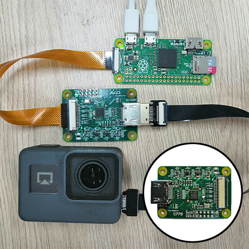

VK5YYY
Posts: 81
Re: HDMI board from Auvidea
Post by VK5YYY » Sat Aug 03, 2019 5:43 am
Has anyone seen or used one of these
Looks like a Auvidea knockoff that's much cheaper
(And you always get what you pay for)
Claims to do up to 1080p 25fsp
eBay item number:202742746378
I think functionally the zero's csi slot is the same as the pi 3 but is a little smaller
Cheers Roger VK5YYY

VK5YYY
Posts: 81
Post by VK5YYY » Sun Dec 01, 2019 1:14 am
Hi Folks
I can confirm this board does work
It appears to be a knock off or at least similar to the Auvidea
No sound (like the Auvidea) and the resolution has to be correct
Will need a decent bit rate to support the resolution
So guess that rules it out for reduced bandwidth, unless it could be scaled
Thanks to VK5BD for persevering with it
Cheers Roger VK5YYY
