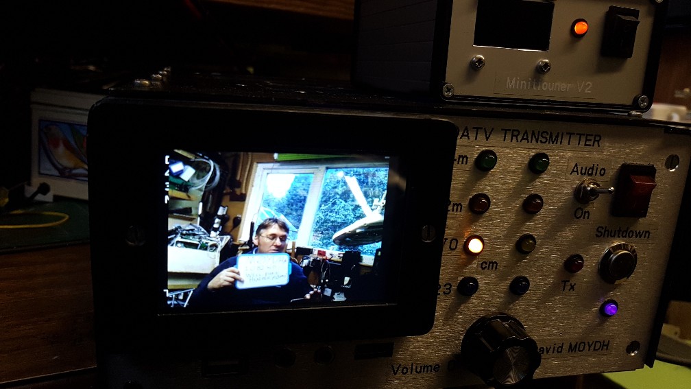

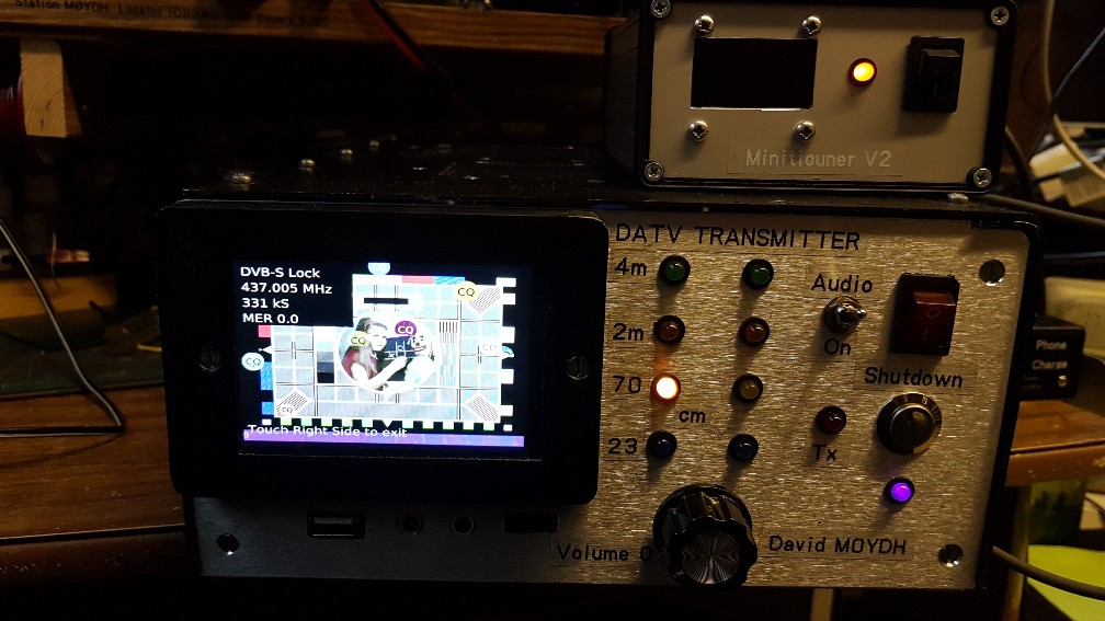

Bravo! The receiver worked straightaway and is really simple to use. Thank you very much.
I'll bring my 2019 with me to Newark show.
David M0YDH
Thank you message.
Thank you message.
