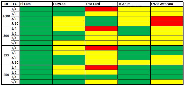

I have investigated the problems with Portsdown and LimeSDR Mini in this release. There seem to be 3 separate problems, depending on the video source, SR and FEC. While I try to sort things out, here is a guide to which H264 modes work and which don't in this release. Note that the green boxes still suffer occasional RF/picture dropouts. The amber boxes give a picture to start with, but soon lose lock. The red boxes never achieve lock. "C920" refers to WebCam mode using a C920 webcam, not the button labelled C920.
Sad to say, I did most of my pre-release testing using the Pi Cam and other combinations that happened to work. Note that if you set 250KS, FEC 3/4 all video sources seem to work.
