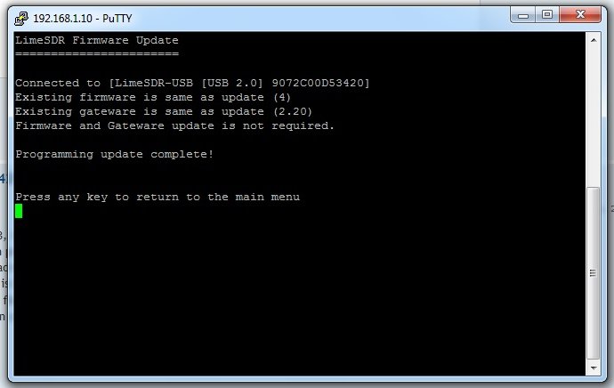

Re: LimeSDR USB Issues
Hi Dave
Thanks for opening the topic
Yes, I tried to update, but it tells me that it is not required.
Something has changed in this latest version, because in carrier mode it only activates and stays fixed.
In the previous version it worked fine. Of that I'm sure.
As for RF levels, I'm not so sure anymore, because I had other problems and I did not measure.
Keep investigating 73 Magi
EA3UM
