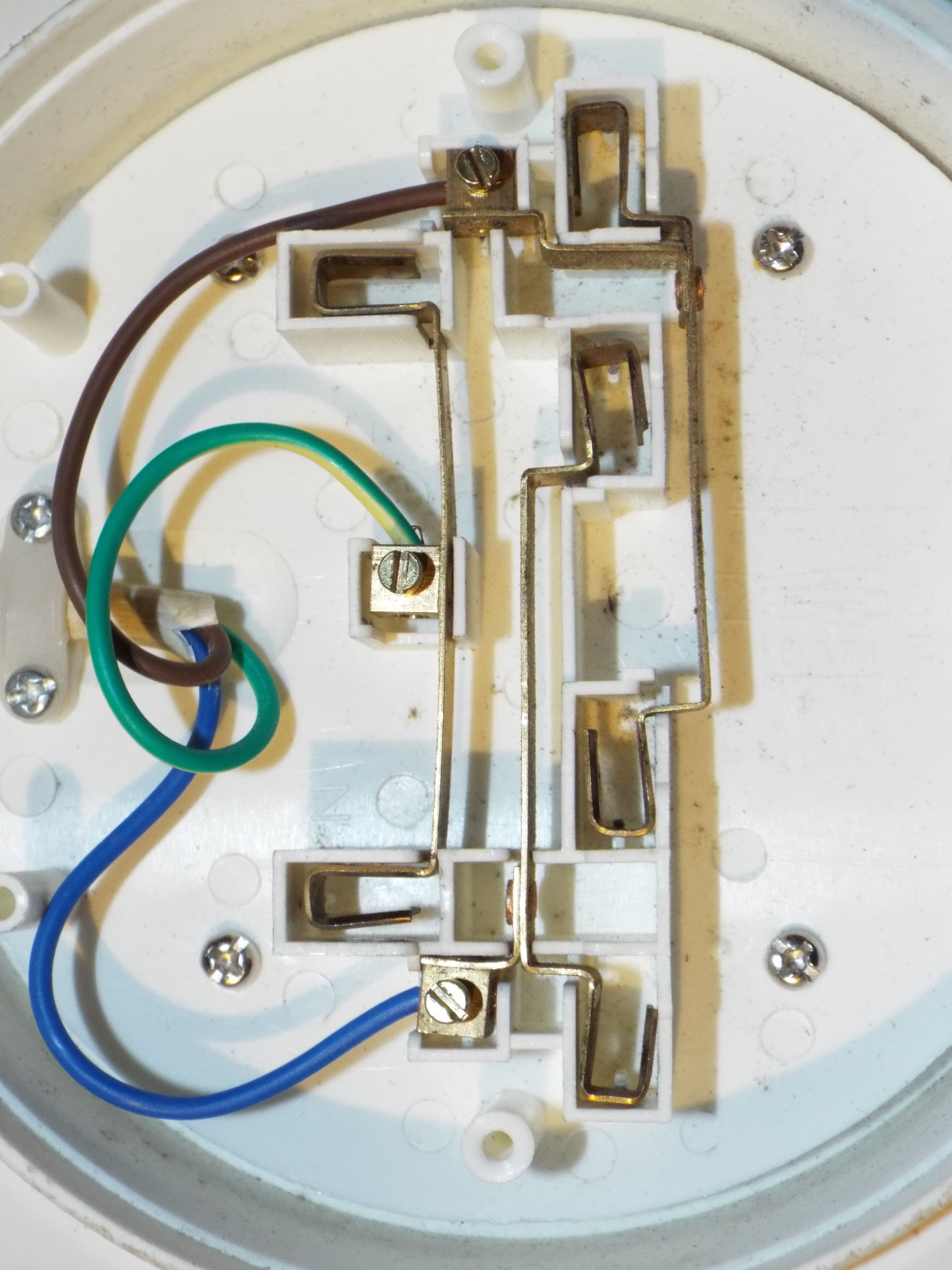

The intermittent fault was found to be the connections for the mains plug in the extension that the analyser was plugged into. They made a very poor contact with the plug prongs, especially the earth one which had virtually no connection, but was OK when I tested the earth loop resistance a few days ago. They were so poor it was impossible to tighten them up (see photo), so now in trash bin.
Poor Connections.
Poor Connections.
