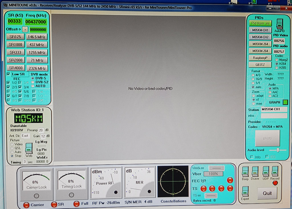

In conversation with Arthur G4CPE he mentioned there was no H264 operation since a recent update. He thought the card may be corrupted and fitted a spare; this restored H264 working. When he subsequently updated the spare that also failed to transmit H264. Arthur said on an analyser it looks like no modulation is happening.
In order to confirm hardware wasn't to blame I located and blew the dust off mine; it worked great on the old software on Portsdown and Ugly modes. Since I have other means of generating the signals I updated mine to the latest software and now that doesn't produce H264 either.

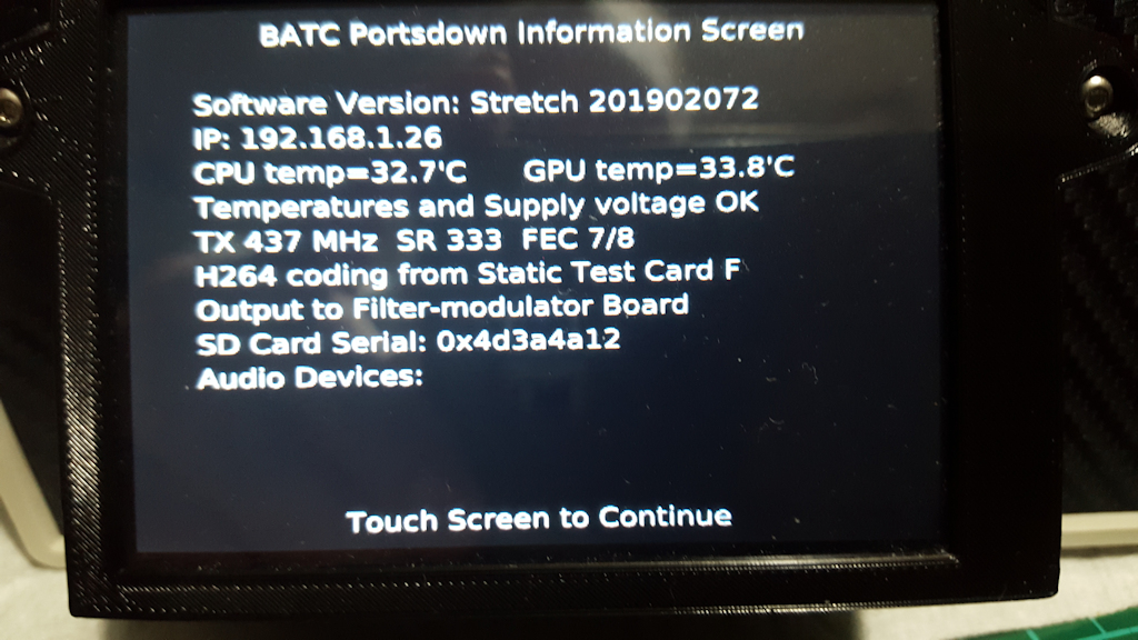

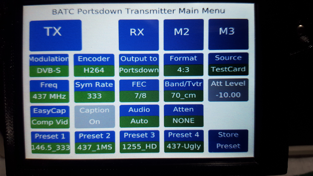

In the meantime, please could you list all the settings on Menu 1 of your Portsdown (or post a photo) so that I can try to reproduce your exact problem. Also please tell me what software version you are running (from Menu 2, Info)

Hi Dave,
These from mine; Arthur might post in the morning.
Steve

Does changing Audio from "Auto" to "EasyCap" or "None" make a difference?
Ray M0DHP

Hi Ray,
Changes in audio settings make no difference.
