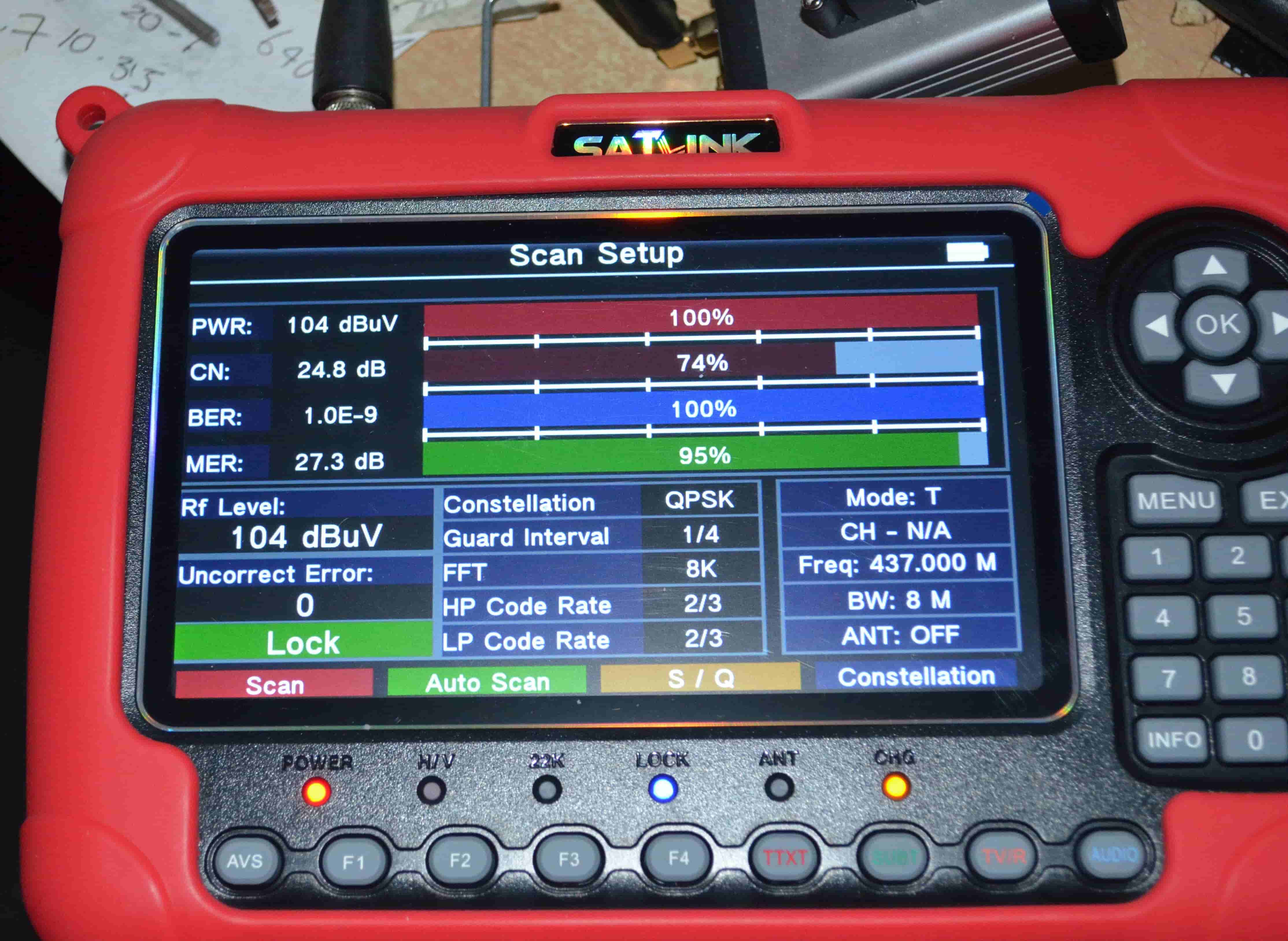

G4GUO
Posts: 736
Re: Portsdown Tx
Post by G4GUO » Fri Jan 11, 2019 10:43 am
Here is 8 MHz DVB-T using a LimeMini, the receive antenna was a hex spanner and the Lime is top right in a Hammond Enclosure.
- Charles
