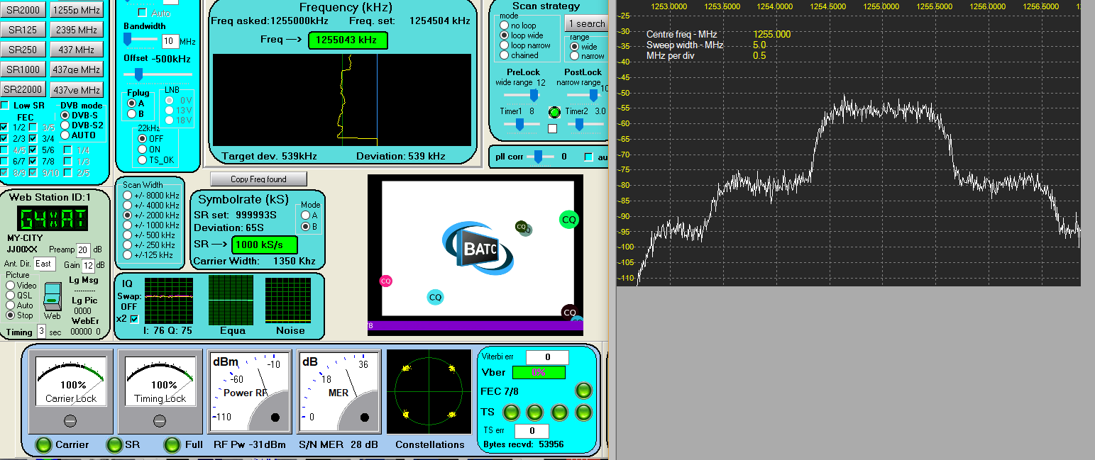

Well it clearly is transmitting from Express DVB as I can see it on my RSP spectrum analyser. Can't get a picture lock on MT out of it though. However, back on the Portsdown, its now working fine on 23 and 13 with a quick-to-lock signal too. Neither of my Plutos now seem to work with Express DVB, not even as a carrier only, so back to the install instructions for them to refresh my failing memory.
Its been wonderfully simple to make the Lime work with the Portsdown, no idea where my 13cm signal went but its here now. Windows drivers remain a real PITA....
Interesting, since the Portsdown update I'm getting 'pops/cracks on the received audio. They don't seem to be related to screen animation, data rate or anything I can pinpoint. Same with Portsdown or LimeSDR as output device. No audio source in use at the moment. Could we have a 'music on hold' option perhaps ;-)
*** Correction, its not now working on 13cm *** but it does transmit at 1990MHz, the highest I can go with my spectrum analyser. Probably not much help as below 2GHz its using the low port anyway.
Something not right somewhere :-(
But a cracking MER and signal/spectrum (1000SR) on 1255 :-)
