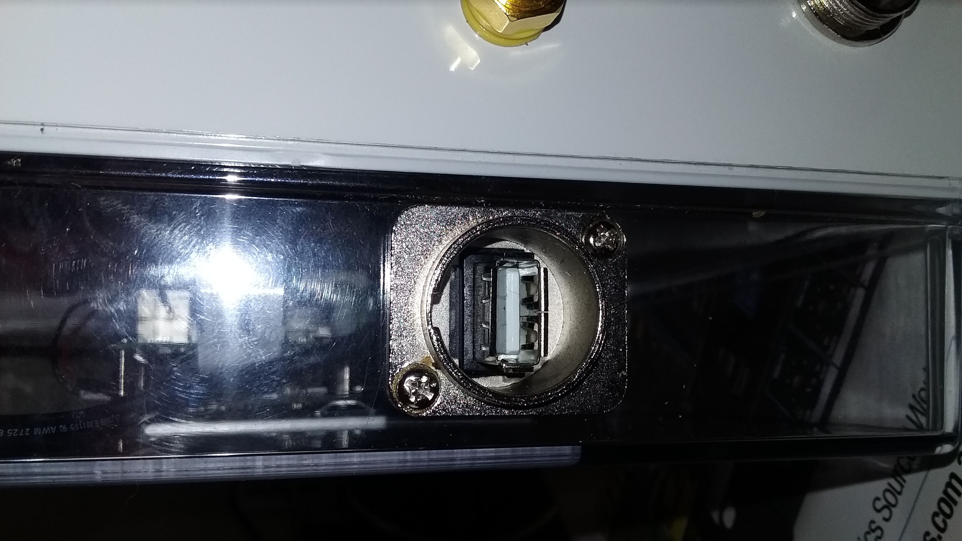

This is a P0835 (23mm mounting hole) from altronics in australia. www.altronics.com.au. I think you will find that RS and farnell do something similar at a higher price.
