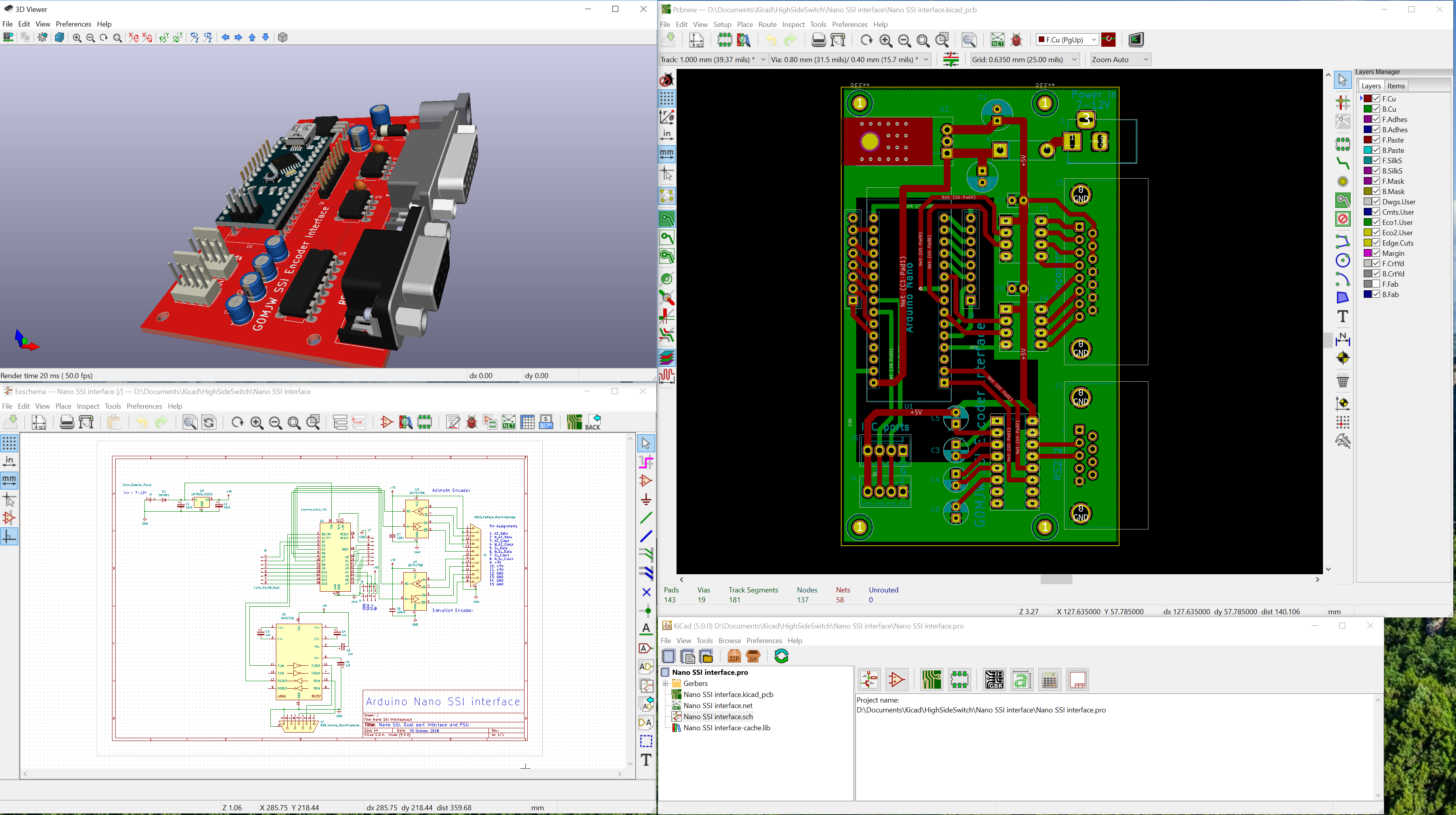

KiCAD - They all have steep learning curves but this one if free and has a strong community. Even some tutorials. It is what I used for the Minitioune and other PCBs.
http://kicad-pcb.org/
Manufacturers - PCBWay, Seeed Studio etc. etc. OSH Park, especially if you like purple.

Elecrow, another Chinese manufacturer, produce some good quality boards, and have a reasonably fast turnaround for the costs. The Gerber files can simply be uploaded to their website after which you select what sort of boards you want, colour etc. and then 'hit the pay button'.
As others have suggested, KiCad is probably the most versatile free package available, and it includes schematic capture, PCB layout, 3D modelling, etc. Lots of parts definitions are available in the form of a library from Digikey, but the part generator is fairly easy to use if you can't find the one you're looking for online. Once you're done, KiCad will generate the Gerber files, and away you go... It'll even export your BOM if you want :)
If you've never done PCB CAD before, it takes a bit of getting used to, but there are bags of tutorials on YouTube, covering everything from getting started to fairly advanced stuff. I found it a it easier to get to grips with than EasyPC which is what we're forced to use at the office.
