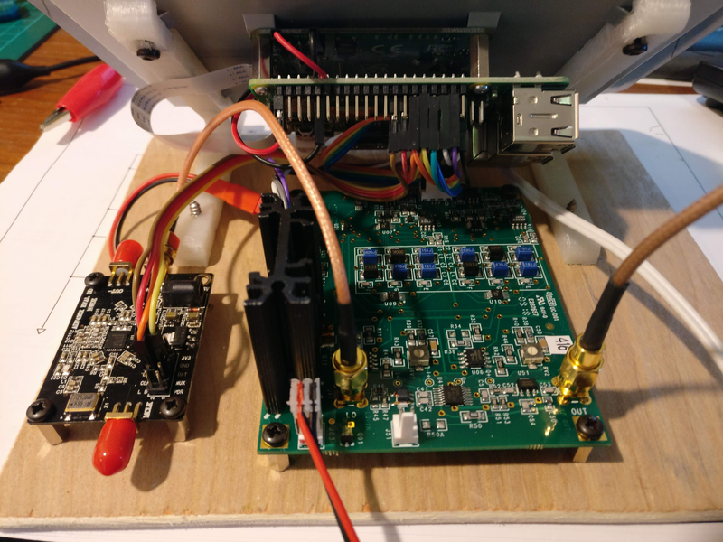

I have a miniml system comprising of an ADF4531 and Modulator board driven by a Raspberry Pi3 with 7 inch touchscreen. Yesterday I added a vMix source on my laptop streaming through WiFi to the RaspberryPi.
For reception I have an old Dreambox500 and a more recent Dreambox800HD. The Dreambox800 seems quite suitable for the Portsdown, I have managed to get it to receive at various sybol rates down to 250k / sec using both Mpeg2 and H264. The old Dreambox500 can only manage Mpeg2, and it cannot lock onto signals with symbol rates below 1000k / sec.
I have been using some SDR radio receivers together with a software DTV decoder which is part of the Sdrangel project, I have struggled with this on some of my reeivers but I ca now decode transmissions from the Portsdown most of the time with some receivers. Things are starting to come together now and I'm waiting to receive a LimeMini SDR in the next day or two and expect this will give better results.
Here is a picture of the minimal system
Up until now I'be been powering the Raspberrypi and Modulator from seperate power supplies. I've been looking in my parts boxes for a suitable power supply for the complete system, so far I have not managed to power the raspberrypi and display with anything except the 5.2V microUSB mains supply, I was hoping to use a small LM2595 module fed from the same input to the modulator but this is not able to supply the LCD and display without problems, this may be a problem withthe bench suply I'm using or the module itself - more inverstigation needed. In the meantime I'm successfully powering the frequency synthesier and modulator from the raspberry pi GPIO bus.
