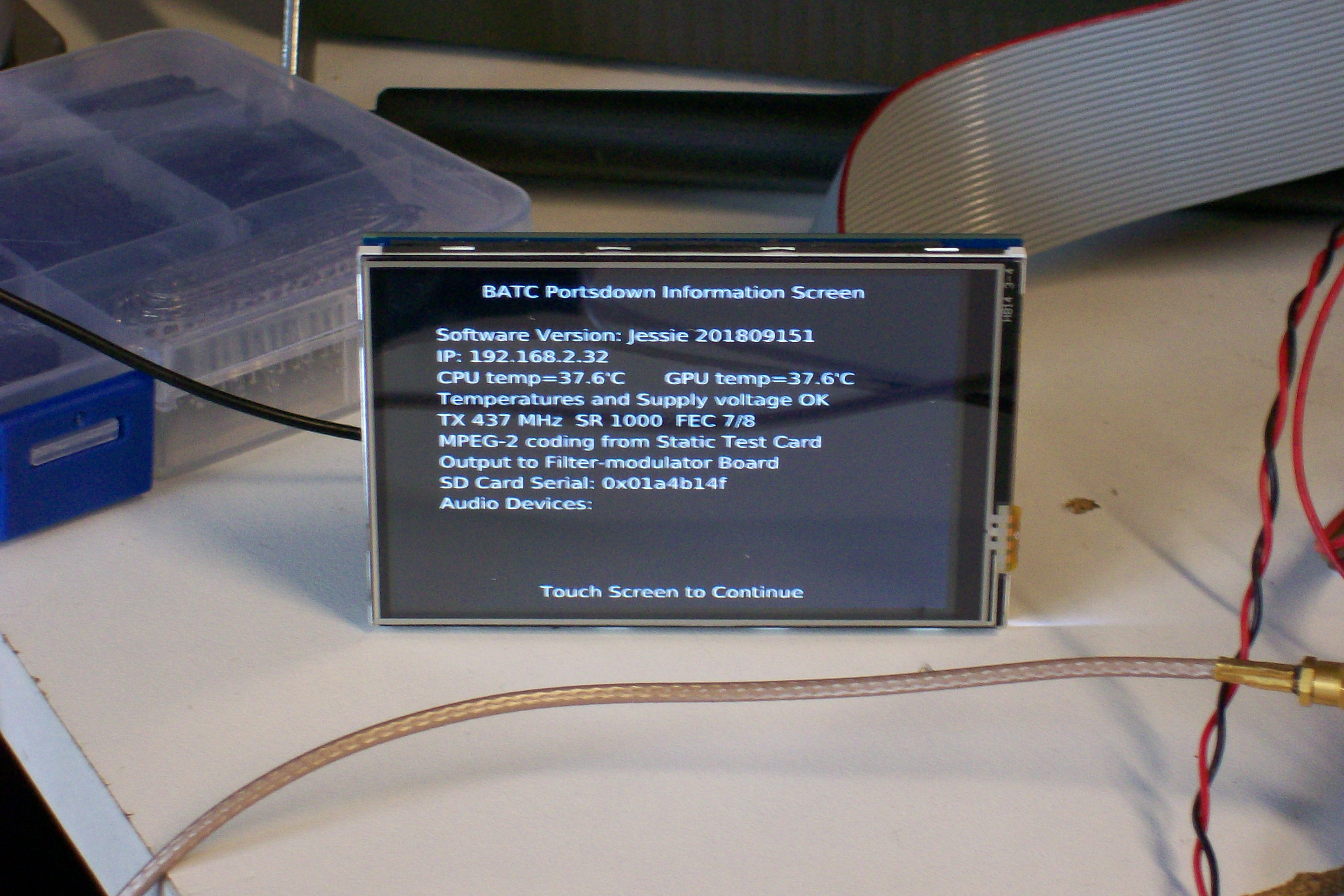

6. What Portsdown software version are you using?
The latest version: Jessie 201809151
I tried to install the Stretch version but the Github site was unreachable. Is that maybe the problem...?
Attached a photo of the Info screen.

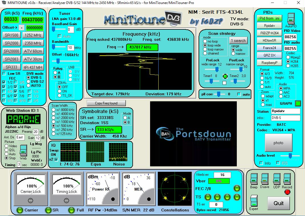

Re: No video on transmit
Hi Dave,
Same result...No picture
The Carrier- and Timing lock indicators are not very steady. They are moving from 0 to 100% and back.
I also found that I'm using a RPi 3B. Is it a better idea to use the 3B+?
Rob PA0RWE
Hi Dave,
Problem solved....
I have a RPi B3+ where I installed Stretch and the 2018 Portsdown software and.... WORKING on ugly mode.!
I don't know if it is the RPi B3 or the software which gives the problem. I will install Stretch and the 2018 software on that B3 and will let you know if it is working as good as now on the B3+
So far so good...
Thanks anyway for help!
