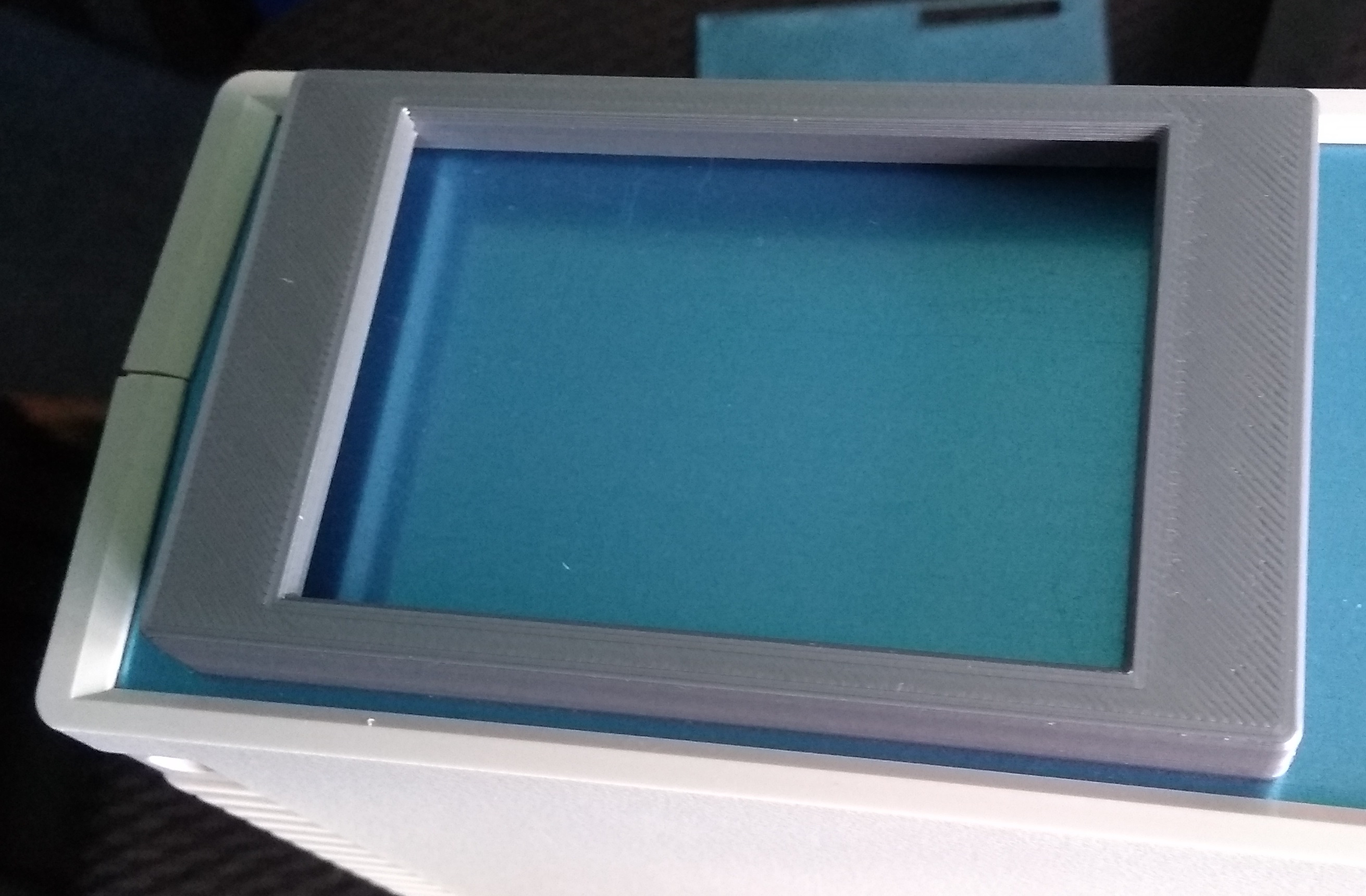

Progress, well some anyway. My nice expensive box arrived and the front panel when assembled only leaves 65mm vertical screen-space. This prompted me to 'bite the bullet' and embark on lots more CAD learning so I could design a screen case that WOULD fit my box. After many hours and 6 trial prints I'm happy with the outcome. Nice filleted outer edges and also leading down to the screen. Looks nice, IMHO. See attached picture. I have 2 RPI touch screens, both have the connection plug in a different place so I have made the back able to fit both.

Gareth the new sitting on the box front panel, about 1mm top and bottom. The old (109x76) and the new, for size comparison purposes. The new housing is 63x102.5.
