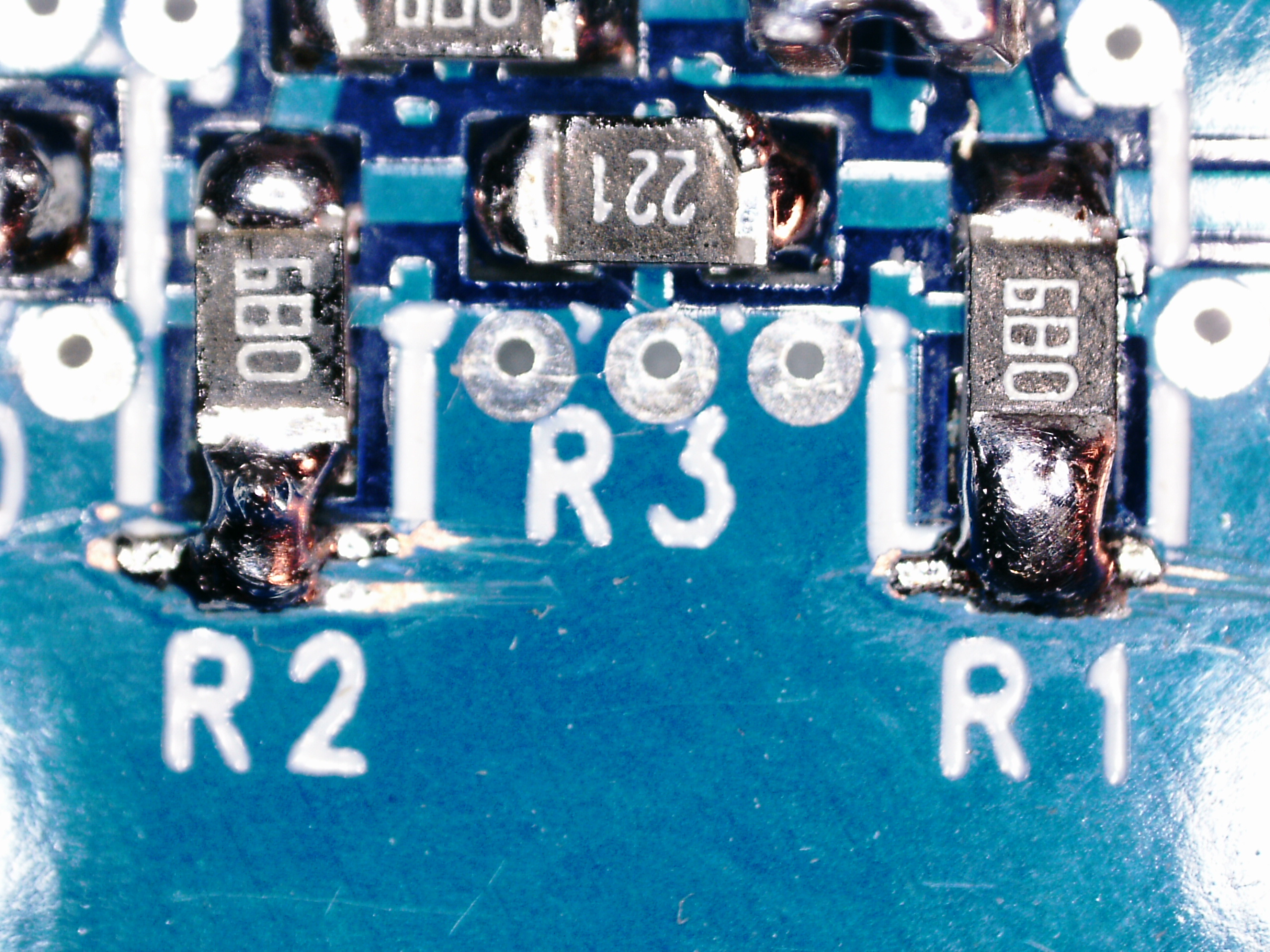

I haven't seen it mentioned elsewhere so I thought I would report the following so it doesn't catch out others.
Whilst assembling the 8 Band RF Switch on a V2.1 PCB under a microscope I noticed that the pads at the ground ends of R1 and R2 in the input attenuator were not connected to anything. It looks like the thermal relief connections to the surrounding ground plane were missed out from the PCB design.
It is easy enough to correct this, just scrape away a little of the solder resist next to the pads and add a blob of solder to join the pads to ground.

I have amended the Wiki to include this. Would you be able to provide a photo of your modified board? All of the development team are still working with Version 1 boards....

Attached is a picture of the modified area.

- Picture of modification to V2.1 Board

I've included it on the Wiki.
