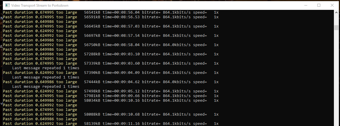

Post by F1SSF » Mon Apr 02, 2018 7:26 pm
Hi alls,
After a long time, I have decided to change my computer , and I have installed again software.
It's OK now, Vmix, and VmixPortsdown.bat running very well.
Also I have some mistakes PASTE DURATION TOO LARGE during batch run.
See attached pictures, what do you think about it?
Best 73 Franck
Re: vMix 2Portsdown.bat error
Post by G8GKQ » Mon Apr 02, 2018 9:56 pm
Hi Franck
Are the transmitted pictures OK? If so, do not worry. ffmpeg complains a lot, but does the work.
If you do not have a good transmission, then we need some information about what SR and FEC you are using.
Post by F1SSF » Tue Apr 03, 2018 5:02 am
Hi Dave,
I transmit vidéo, and pictures across Vmix, and it's perfect.
.ffmpeg complains a lot
Thank you for this capital information :P
73 Franck F1SSF
