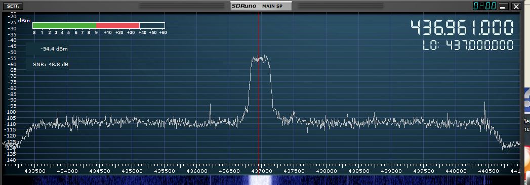

After years since being in the electronics fault finding feild as a job I forgot one of the first principles. Check the volts!. The output IC U51 was changed as there was signal in but no signal out. Still no output!!! Look at the circuit and the volts are fed to it via L50. Check it with a meter with the power off and it is open circuit. Check it with the volts on and no volts on U51!!!. Change it for another choke (the only one I had was rather big but still a choke) and the output returns. BUT the signal is not looking good.
Output with fault 01.JPG (86.39 KiB) Viewed 3692 times
This does not lock any RX as you might expect so back to fault finding....

One of the data wires had broken in all this fault finding (D2) and therefore the receivers would not lock.

During all this one of the data wires broke so the output was not what was needed to lock a receiver. Using a SDR to check the output showed the narrow bandwidth so indicated the area of the fault.
