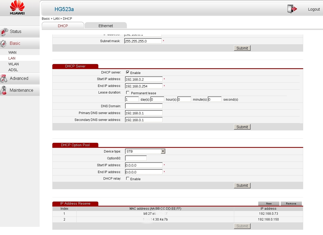

Sergio,
I also wanted to fix the IP address of the PI but went about it slightly differently.
I set my router to always assign a certain IP address to my PI.
All I needed was to find the MAC address of the PI and put this into the router's DHCP reserved address list.
See the last block on the attached picture - my PI is .73 !
Use
ifconfig
from the putty software to find the MAC address, or look around your router when it is connected to the PI.
