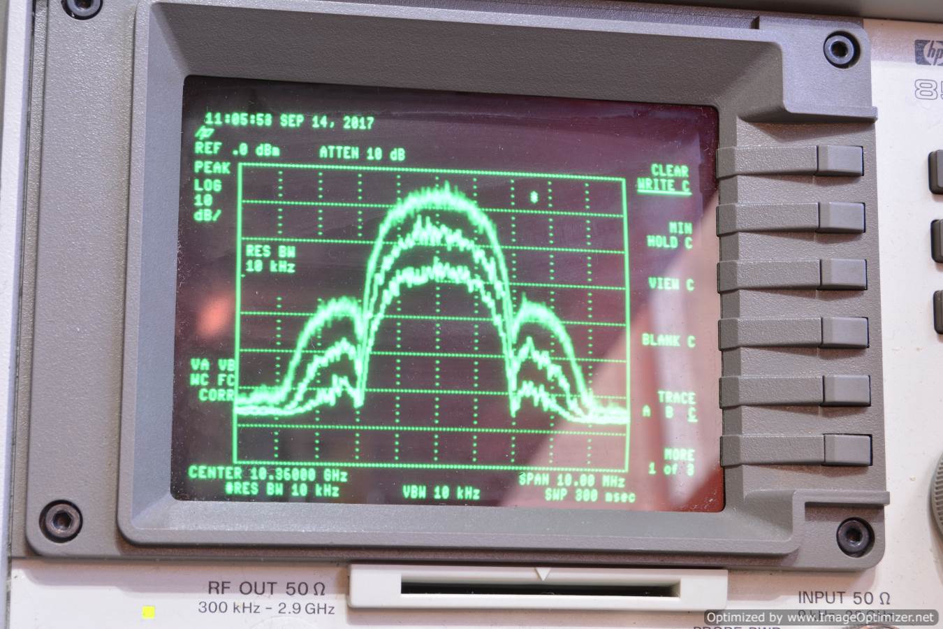

Here's three spectra with varying amounts of attenuation into the transverter; they all look the same just lower.
I'm only seeing about -8dBM from the Portsdown at 136MHz, so thats not really enough to fully drive the transverter.
Will take me some time to convert this from something working on the bench to something I can take to a hilltop.
More projects!
Mark

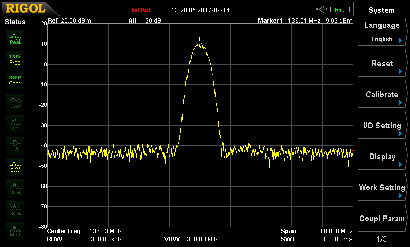

Post by G8GKQ » Thu Sep 14, 2017 11:15 am
Hi Mark
Have you got some attenuation after the Portsdown? You should be getting nearer +10 dBm out of it at 136 MHz.
g0mgx
Posts: 34
Joined: Sat Dec 31, 2016 7:57 pm
Re: Transverting up to 10GHz
Post by g0mgx » Thu Sep 14, 2017 12:08 pm
Interesting, my Rigol says +10dBm
Falling foul of my own stupidity somewhere along the lines; I'm not used to such wideband signals and I suspect my resolution bandwidth is playing tricks on me.
Mark
