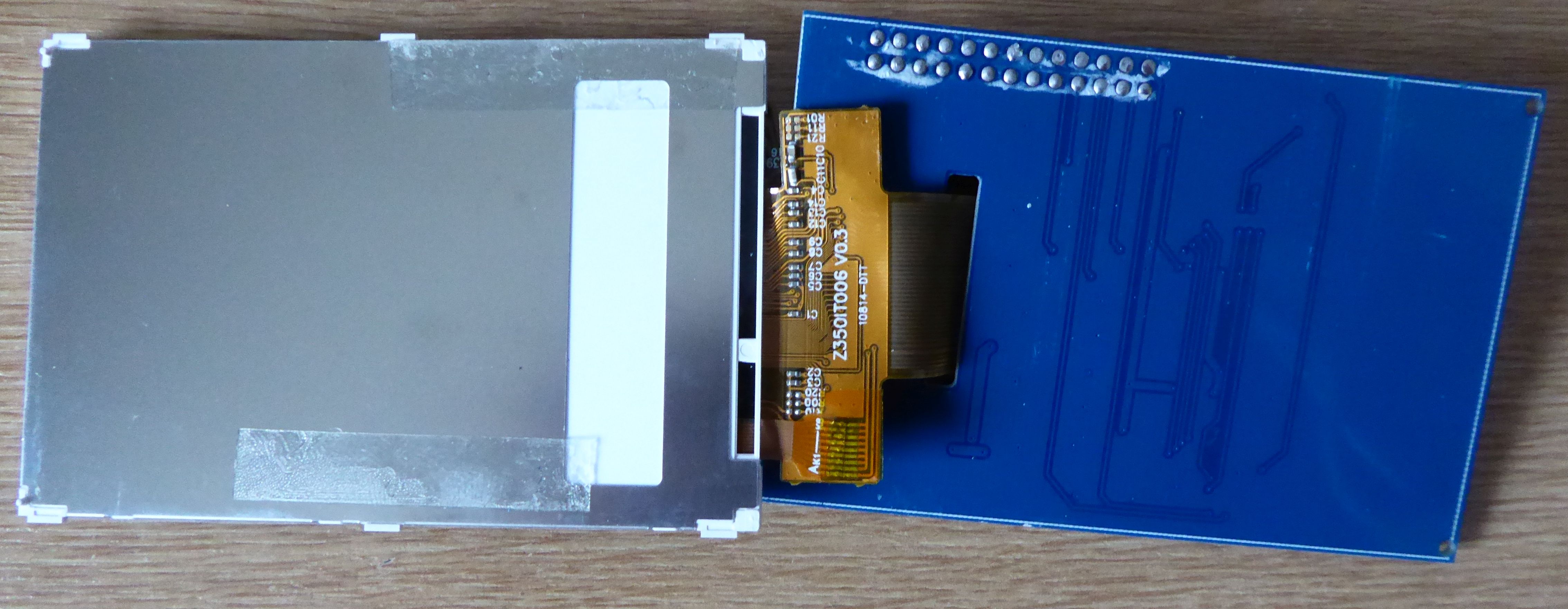

Thanks for the info - my first screen was faulty too. Trying to fix it I found you can prize the screen off its PCB, it is held on with double sided tape. A think piece of this tape is preventing short circuits. Not what I would consider a good design. I will check for poor contacts and maybe improve on the mounting.

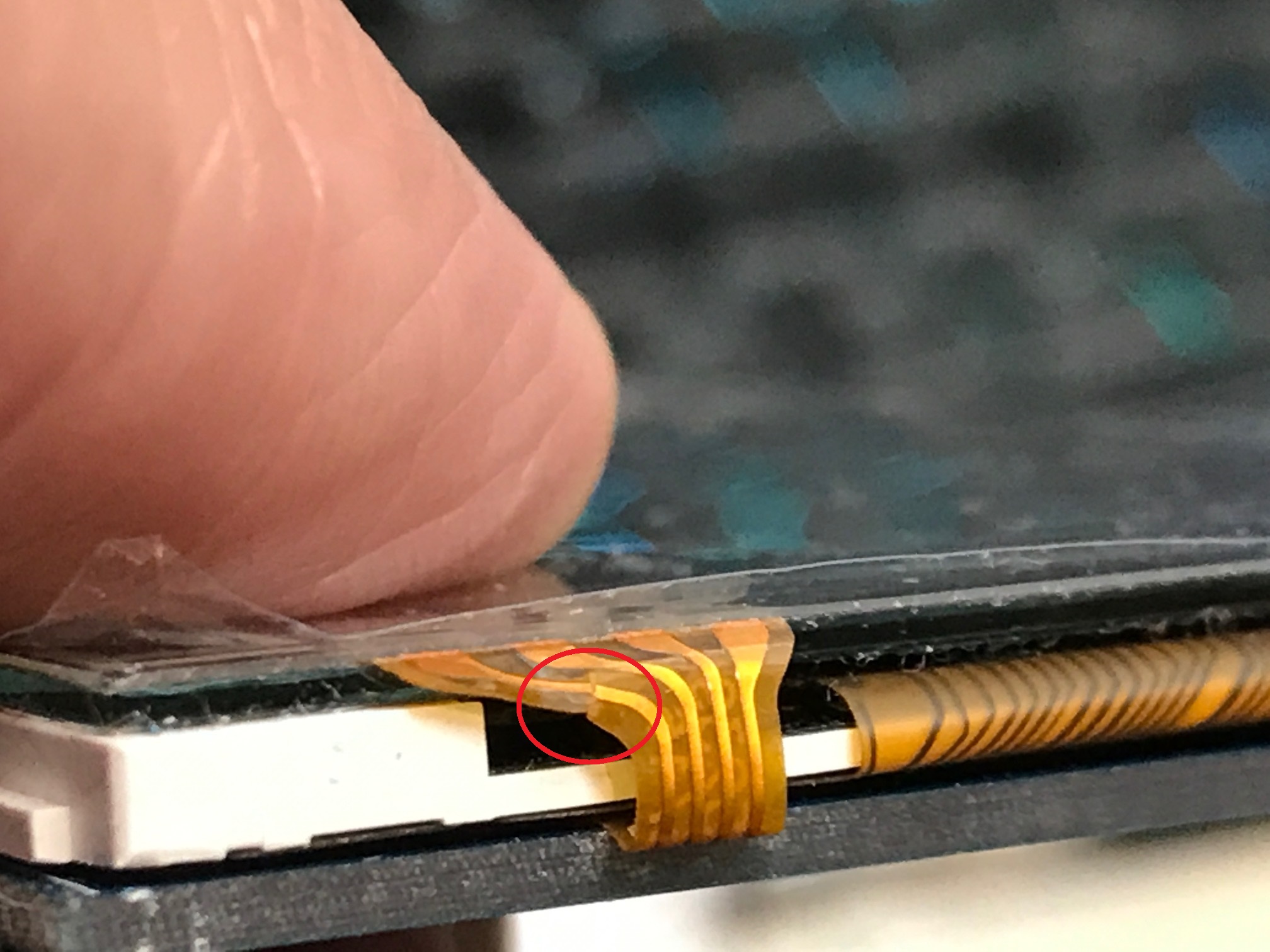

Touch screens that don't work, often have damage to this flexible PCB.
This one was damaged fitting it into the case it came with!
But often caused by pushing on the cable when plugging it in and out of the Pi.

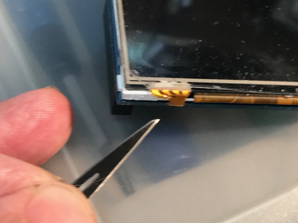

I managed to fix this one, but its not easy :o
Scrapped down to the copper with a scalpel.

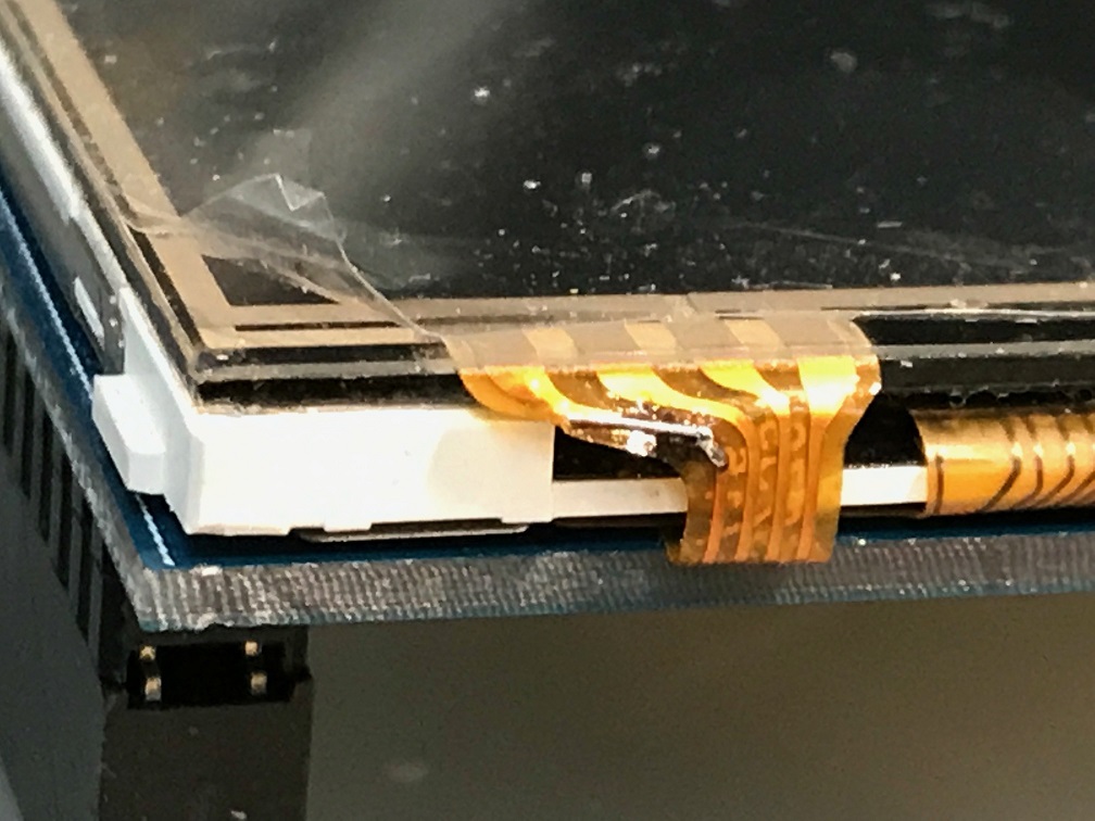

soldered a wire across.
Will strengthen with epoxy next.

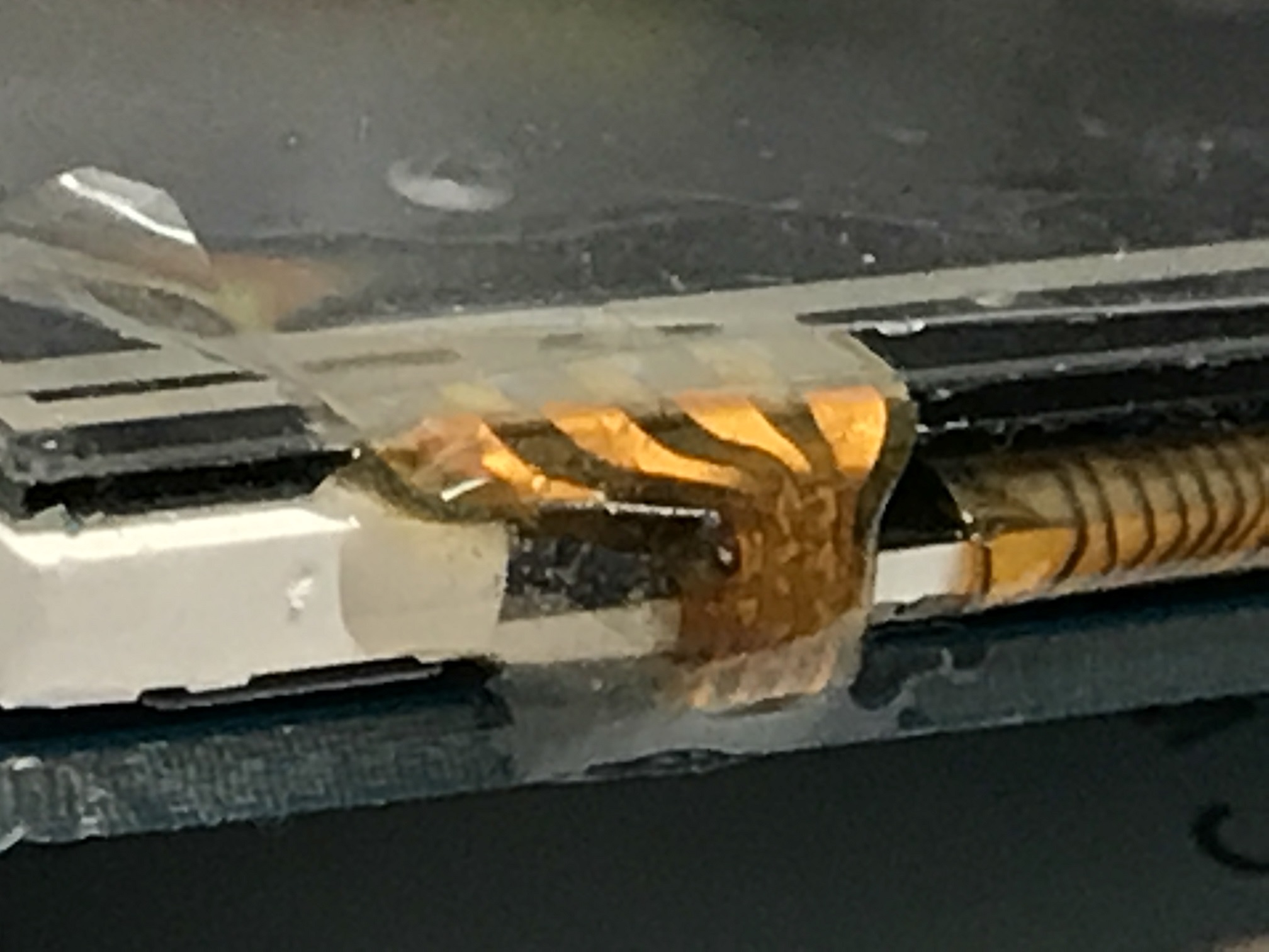

Post by G4KLB » Tue Jun 27, 2017 5:05 pm
Job Done.
touch fixed.JPG (365.48 KiB) Viewed 5189 times
Not pretty, but its not like anyone will see it :D :D :D
