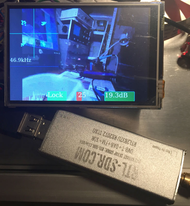

F5OEO had included F4DAV's innovative LeanDVB receiver software within the Transmitter software build, and from software release 201612310 this is included in the core functionality of the Portsdown transmitter. The software is described on page 18 of CQ-TV 252 and at http://www.pabr.org/radio/leandvb/leandvb.en.html.
On a Raspberry Pi 3 using an RTL-SDR, it will receive anywhere between 24 – 1766 MHz and decode at up to 500KS/s and display on the touchscreen LCD. I used an RTL-SDR from http://www.rtl-sdr.com/buy-rtl-sdr-dvb-t-dongles/ but there are cheaper ones available.
The software is not as good as MiniTioune at digging signals out of the noise, and sometimes takes a while to lock, but is well worth playing with as a stand-alone test receiver. It uses the same parameters (frequency, SR, FEC) as are set for the Portsdown transmitter, either through the console interface or on the touchscreen.
For those of you who want to try to improve it's capability by tweaking the sample rate, the settings can be adjusted in the file /home/pi/rpidatv/scripts/leandvbgui.sh on the Portsdown software build. It is a shell script, so you will just need to restart the receiver to apply the new settings. If you find improvements, please publish them here and I will put them in the core build.
