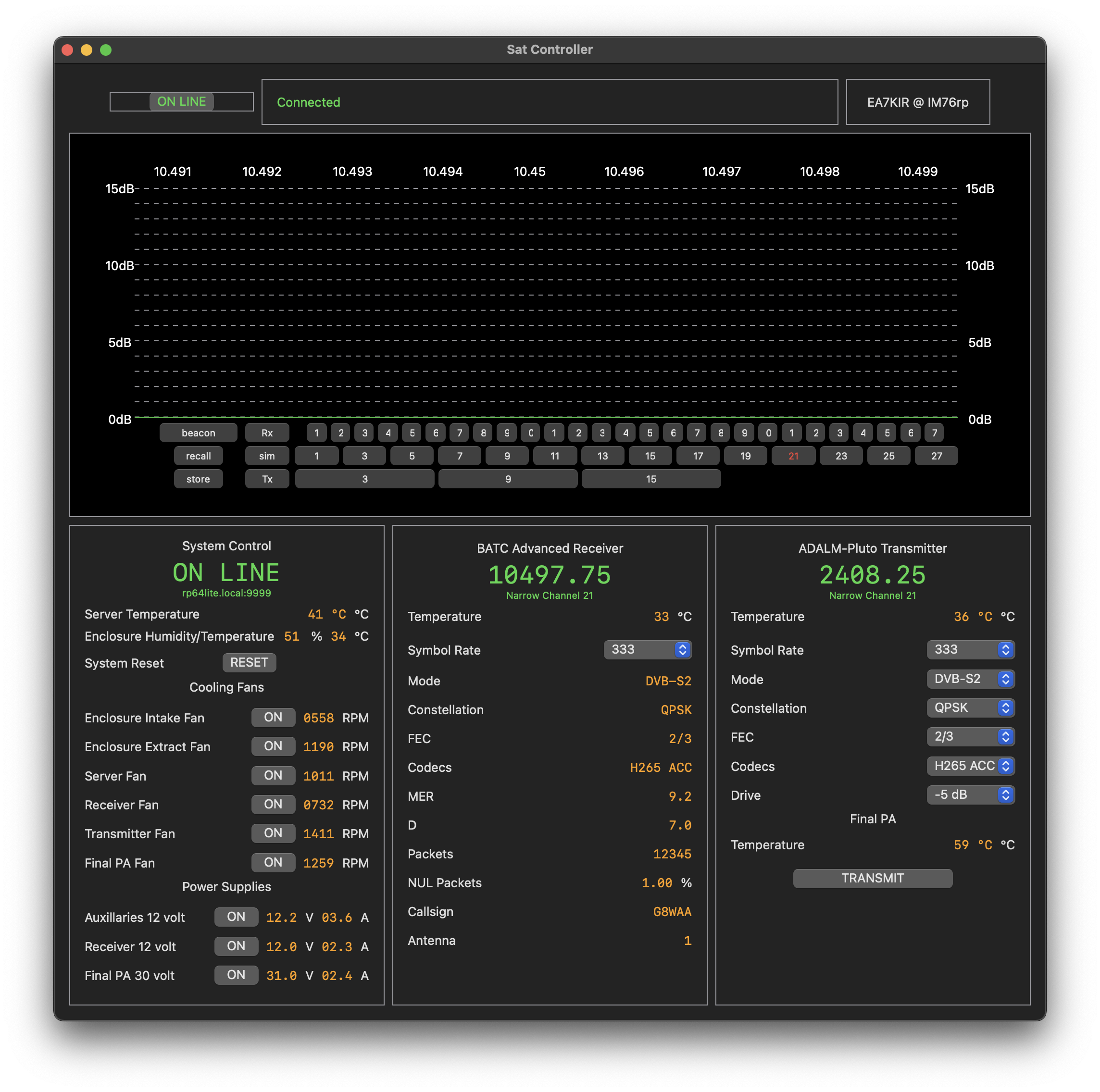

Post by EA7KIR » Wed Aug 25, 2021 7:17 pm
I've got this far, but now I need to ask for someone to tell me the correct way to access the Goonhilly FFT stream.
I'm hoping to add it into this client/server system I'm working on. Thank you.

After only 76 views from other members, congratulations on being the first to respond. But no, that is not what I'm looking for. I'm after the raw fft stream that goes to LiveTune and those 2 French guys who don't open source their code. So it is possible and it would only increase the data flow by one user - as with any other use who accesses the web page. Searching through the GitHub undocumented source code is futile. Believe me, I've tried.

Thus far, I know I get a continuous stream from wss://eshail.batc.org.uk/wb/fft, but I've yet to discover how its packed. A couple of sentences that explain what's going on would be extremely helpful. Anybody?

When I'm happy my software is ready, I'll splash out the dosh and buy a dish and all the other stuff. I'm aware it might be possible to source the spectrum data directly from the Pluto, so (in theory) all I'll need to do is change an IP address.

I'm not Spanish. Check out my website https://michaelnaylor.es. There's a link to my GitHub page where the source code will be published. At present, you'll only see the README file, because the code has memory leaks that are proving difficult to solve.
