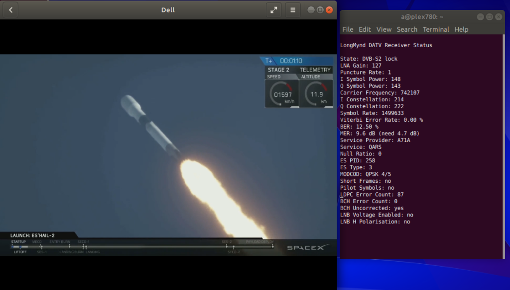

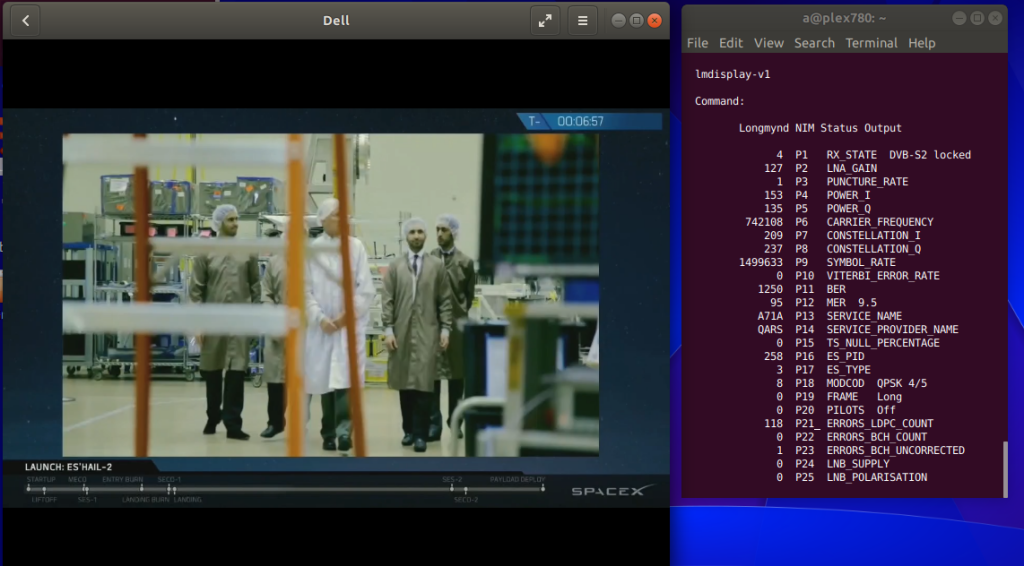

This is an example of Brian's status output:-
This is an example of Davids status output:-
Both pictures are using output from Totem a Linux based video player, it could be set to VLC by changing the totem line to vlc udp://@0.0.0.0:2000 also assuming you have the extra codecs installed in Linux to display some video formats. Timing for me is typically less than 4 seconds from clicking on a signal in Quicktune to a picture being displayed on screen.
Remember to edit the auto files as required depending on which package you prefer. Note that as it is, the quit file will kill all.
