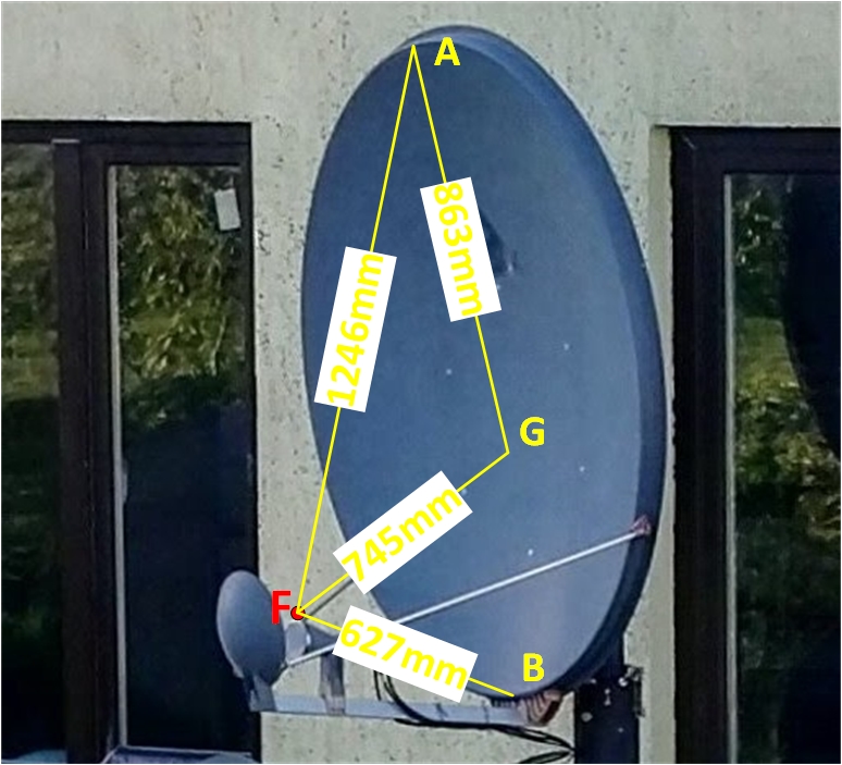

Mike! From the measurements I made long time ago I just made this drawing for you. In addition I wish to mention that an offset angle of the main mirror is 27.3* and opening angle (angle AFB) is 86*. F/D equivalent .62.
What else... I would advice you to do the string test to the main mirror (those antennas are so old and made out of aluminum, so they are usually warped). Secondly, when you try to adopt this antenna without sub-reflector, do not do unrecoverable things such as cutting the feedarm. So, after experiments you will be able to return to dual-reflector design. BTW, the beauty of the Gregorian type antenna is having sub-reflector on. :D
If you need some ideas how to make special LNB-holder for your Gregorian, say so, I have some.

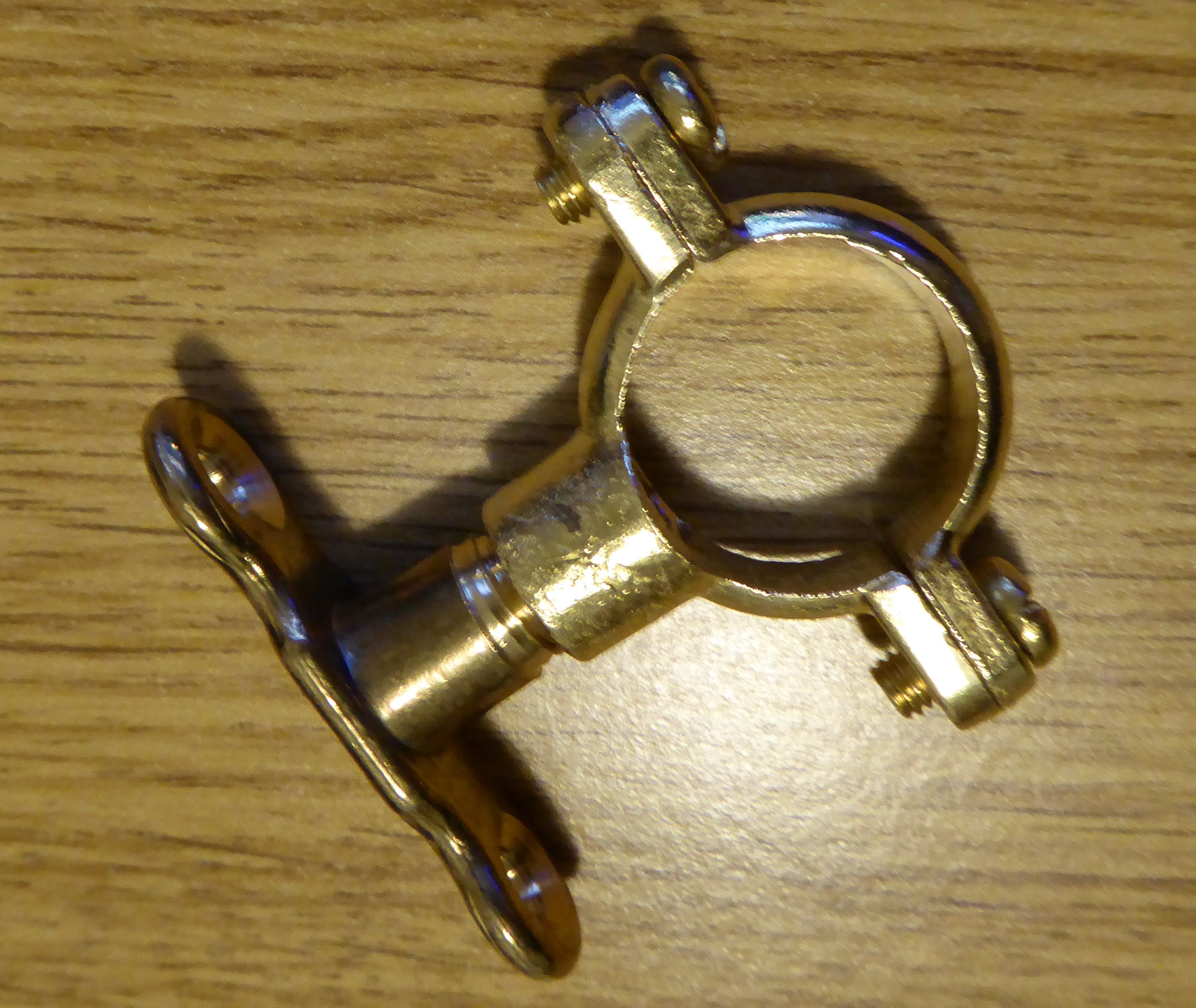

If you are looking for mounting hardware for a POTY type feed, I had the same issue earlier this week and found a solution in B&Q ( I was desperate).
I am sure these are available elsewhere. A 6mm drill, some M6 bolts, bit of aluminium strip plus this (all from B&Q)
They are called Munsen rings - https://www.diy.com/departments/plumbsu ... 135_BQ.prd
I am sure they are available for a more reasonable price elsewhere. Screwfix for example. The large thread is M10 and you can buy extenders or use a long M10 bolt and pack it to the right height.
In my case the POTY feed fouled against the feed arm and needed to be a bit higher above it. My solution to this is to modify the feedarm to be lower - e.g. bending it brute force if that's practical or through adjusting it's mounting. In my case the latter as the feed arm attaches to the back bracket using 4 bolts and all it needed was a minor adjustment with a file to two of the holes in the mount.
Yours above looks a very similar arrangement but it might fit as is..
