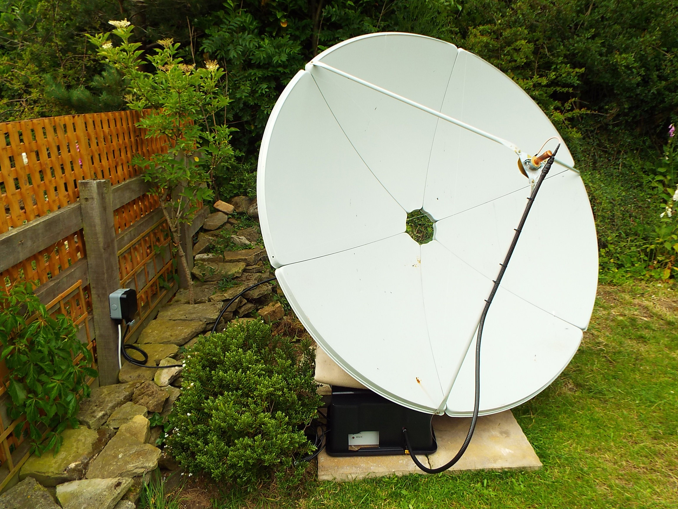

I also have one of those 1.8Mtr dishes.
It arrived somewhat worse for wear - dented from poor packaging - so got a partial refund for that.
Assembling was a nightmare - holes for the segments did not match up and also required much drilling and filing to get segments to line up. I used the supplied mounting stand and there were a number of bolts missing so a trip down the road to the local builders merchants was required.
The LNB mounting arms were twisted and required bending to get them to fit - I will probably replace those soon.
As for receive I found my 1Mtr dish gives a better signal, so for time being I am using that.
It's probably not aligned quite correctly yet, but I have found that 6W works well, at 125 K/S, 12W at 250 K/S, and around 24W for 500 K/S, so seem to be getting the same performance at 2.4GHz transmit. Based on that 80W seems about right for 2 M/S.
Until I get a bigger amplifier can't do much more.
Nick - G4NKV

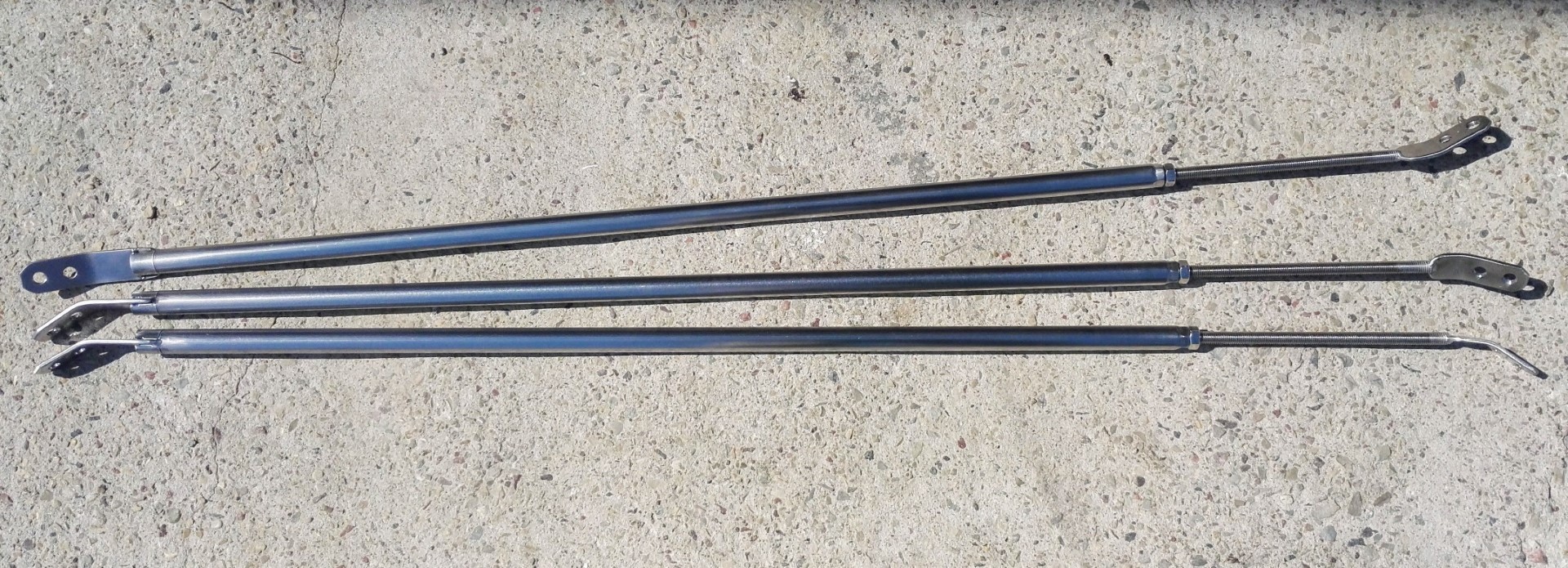

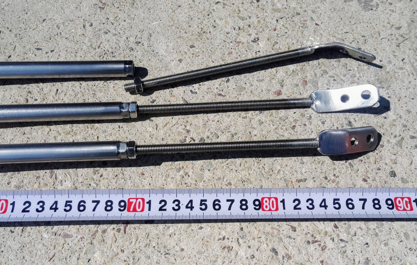

I have set of extendable feedarms (from 70 to 90 cm ). Those would last much longer than antenna you got, as they are INOX made. :D PM if interested.
