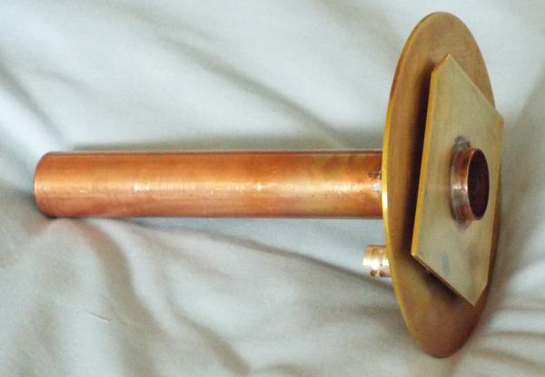

OK built the patch antenna, but before I go much further and do the cone, I believe I have some black nylon6 some where, will have to check it does not get hot in the microwave first.

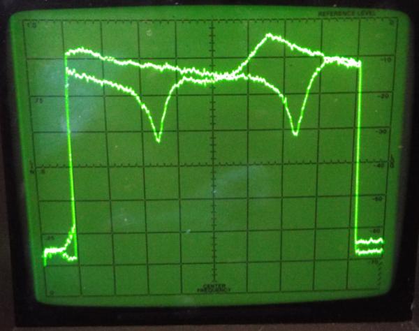

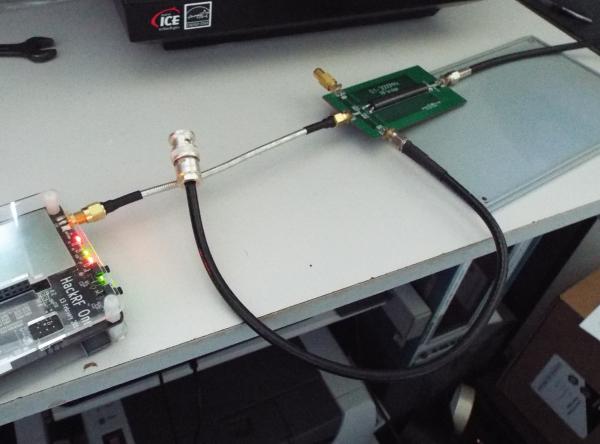

thought I would post some pics of the results, I have used one of the 3000MHz RF bridges to find the two resonances testing VSWR first with just a co-axial tail on and then after with the Patch connected.
So this is the test set up before:
This is the result the top line is the open co-ax and bottom is connected to the patch:
And this the patch.
Now the questions the traces are 10 dB per div vertical, and 50 MHz per div horizontal.
The two resonances are 2317 MHz and 2514 MHz which seem a lot wider then the patch instructions so. The question is is this two wide. The dims are within 0.04mm on my calipers which is about as good as I can get.
Is the metal too thick? Do I need to start bending? Or will this be OK?
Cheers
Adrian

Looks OK - perhaps the thicker metal explains the extra spacing. 0.04mm is pretty good.

OK thank you for the response, the patch filled a day in the garage so no great loss if it was not suitable, I would just go buy one from somewhere, seen some for sale in France!
I will do the cone next and see if it brings it slight down in freq, I was surprised that it was basically above and below 2400.
Can you please do me a favour as I do not understand, can you show the resonant lengths along the patch for above and below or point me to an explanation, all the ones I have seen so far have been slightly off square square patch antennas.

I would test it and see. The cone design by Willi works well - https://rfantennas.files.wordpress.com/ ... .jpg?w=768 see https://rfantennas.wordpress.com/2019/0 ... vergleich/ Google translate make a good job of translation to English.
