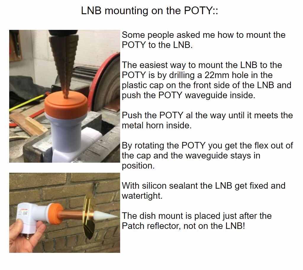

I forgot to mention, that I did do the cutting a hole in the centre of a normal Octogon PLL LNB thing, but had terrible results. What is normally a 7db MER+ on the Beacon ends up being around 4db MER :(
My unproven theory is that a POTY (with some type of lens on the front) is more familiar to a rocket LNB, than a normal LNB that effectively has its horn removed.

How, exactly, did you mount the LNB? It is important the new lens is in the focus, (typically same place as the old feedhorn was). That's not so easy to do and generally requires adjustment in-situ.
Sawing off the horn is drastic, especially considering the investment at risk often exceeds €6, but it is the best way to go.

I followed the exact instructions that you linked to :) Drilled a hole, and pushed pipe all the way back, and turned pipe to reduce flex.
I had MiniTiouner in front of me while I tried to make fine adjustments. The best I got was about 5dB MER max. I would imagine some non-rocket LNBs work better with a pipe than others. Mine is an Octogon Green PLL so if anyone has used a POTY with this LNB in this way, and has gotton better results, please let me know so I can try harder!
