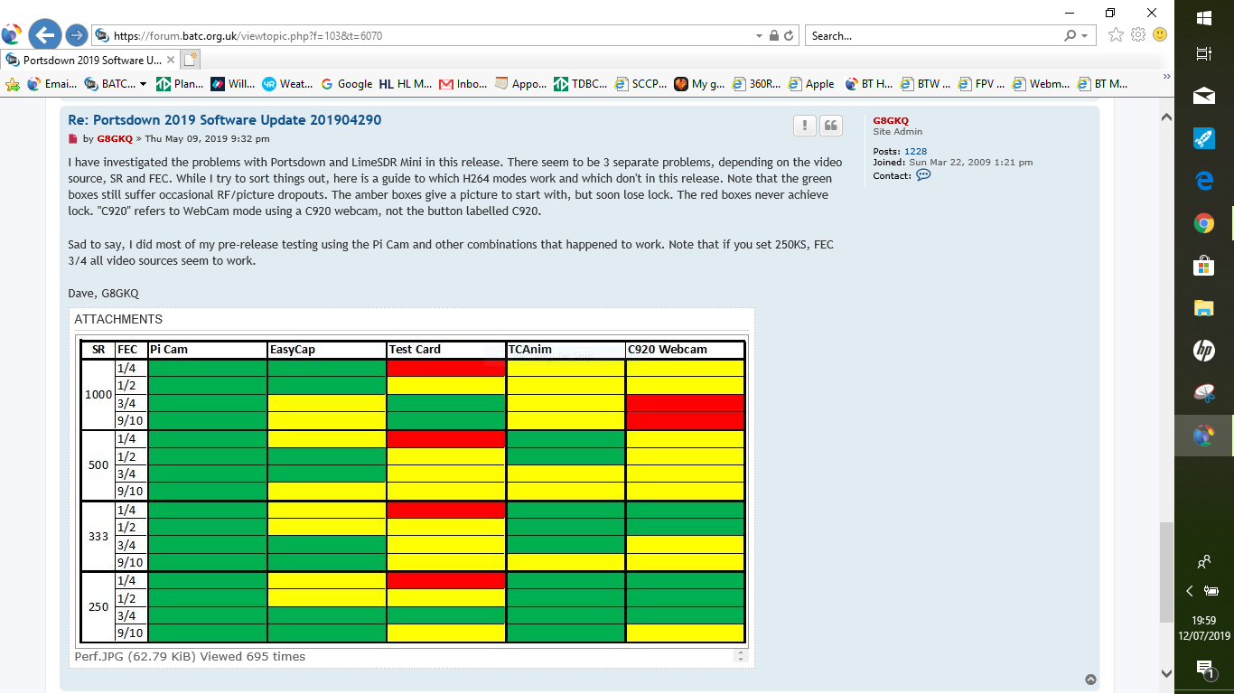

Hi Martin..I use the Lime with the Portsdown and it seems to work very well.
At an SR1000 and FEC up to 2/3 I can get through Oscar 100 with 40 watts and a 1.2 M dish
This was using the Pi Cam...£6 on Ebay! and a C290 Webcam for the audio.
There is a very useful table which helps to show what will and wont work ...
See attached![Image]()
See attached

Re: Transmit Line up which Works!
Hope that the above is helpfull ...sorry about the multiple copies...The pasting of images on this forum always catches me out!

Thanks for that. Here is the link to that page as well...
viewtopic.php?f=103&t=6070#p19583
