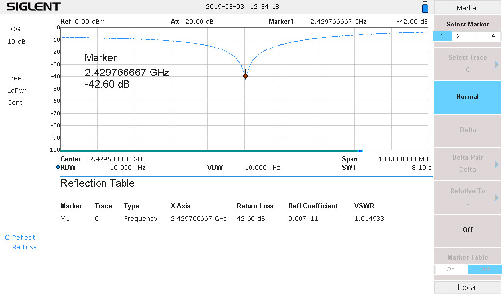

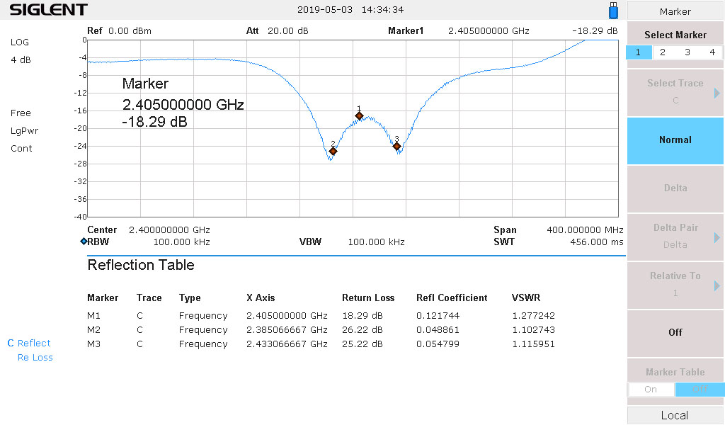

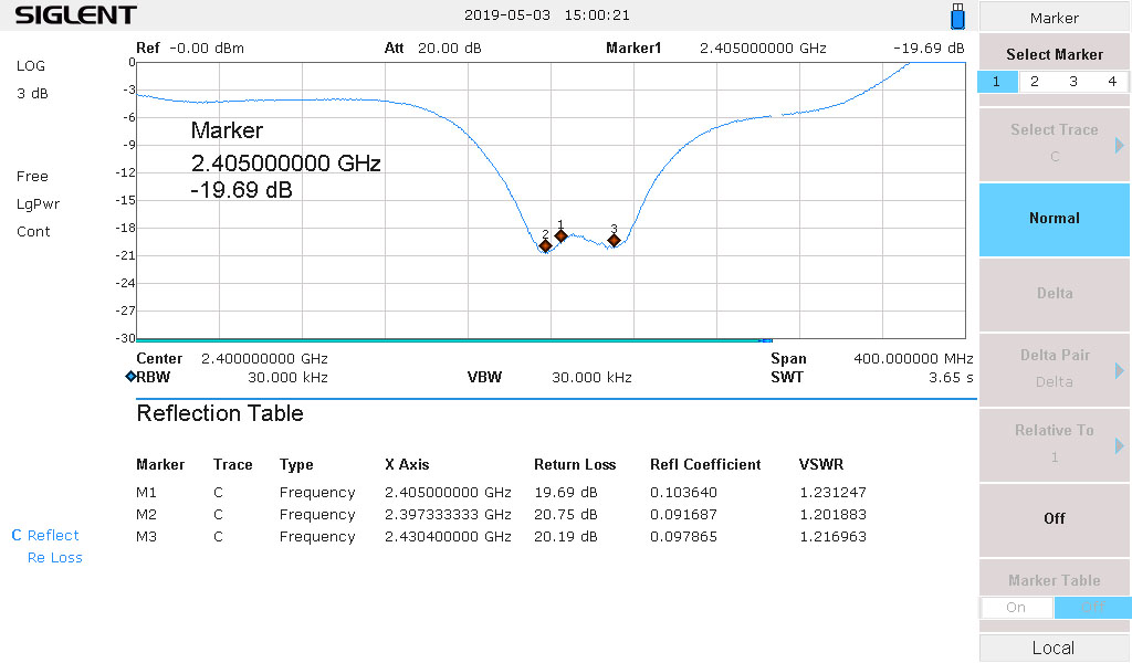

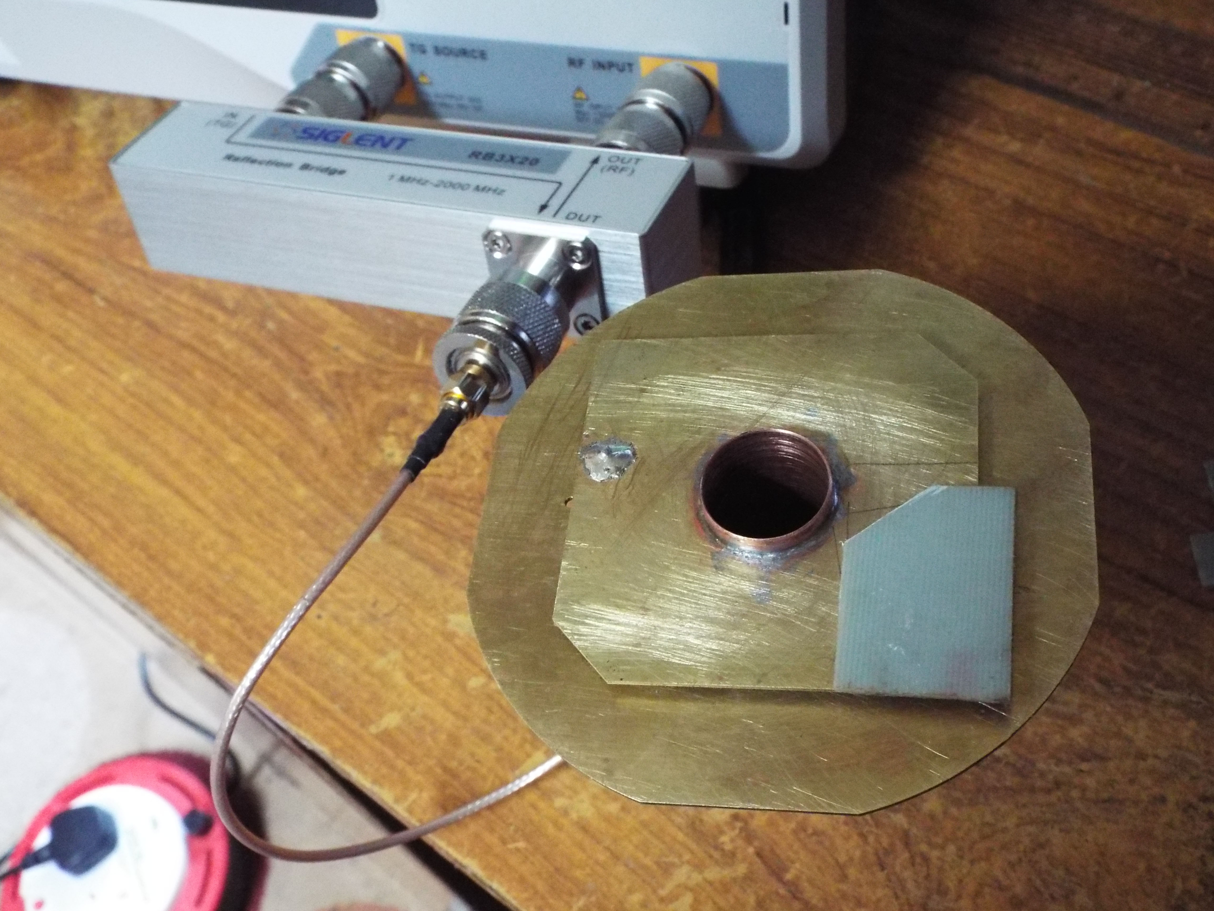

Posted: Fri May 03, 2019 4:14 pm
by Nick
I have also had some difficulty adjusting my patch. When checked it showed a single resonance point at 2.429GHz so not likely to be LHCP. By adding a bit of copper (I used a piece of PCB) to the patch I have been able to obtain two different resonance points 33 to 48MHz apart.
By varying the positioning of the copper I can get different results, such as two sharp resonance points or two points with a flatter response between them.
I don't have a VNA and the refection bridge on the Siglent analyser is only rated up to 2GHz, so don't know if the results are accurate.
Does any of the results I obtained look OK to use ?
If so I can make a final version using some copper tape soldered in place.
Patch as built response.
Patch Original.jpg (99.07 KiB) Viewed 10271 times
Patch Modified.
Patch Modified.
Patch Modified.jpg (1.47 MiB) Viewed 10271 times
Patch Adjusted 1.
Patch Adjusted 1.
Patch Adjusted.jpg (109.7 KiB) Viewed 10271 times
Patch Adjusted 2.
Patch Adjusted 2.
Patch Adjusted 1.jpg (110.25 KiB) Viewed 10271 times
Re: Hints on tuning the G0MJW feed patch
Posted: Fri May 03, 2019 6:27 pm
by g0mjw
That last one looks good.
