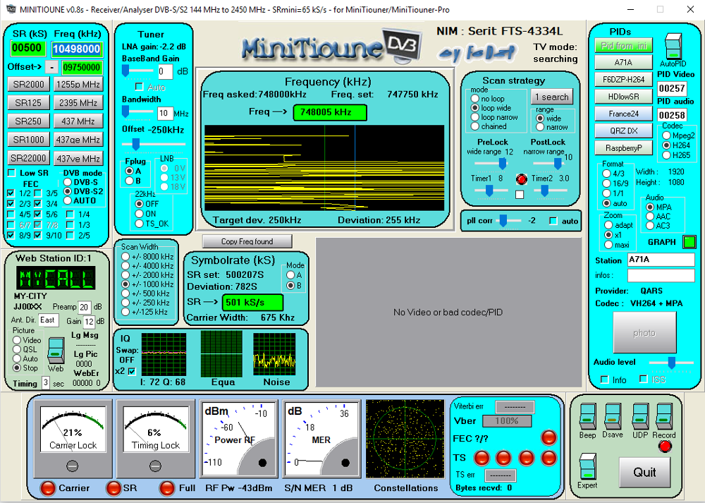

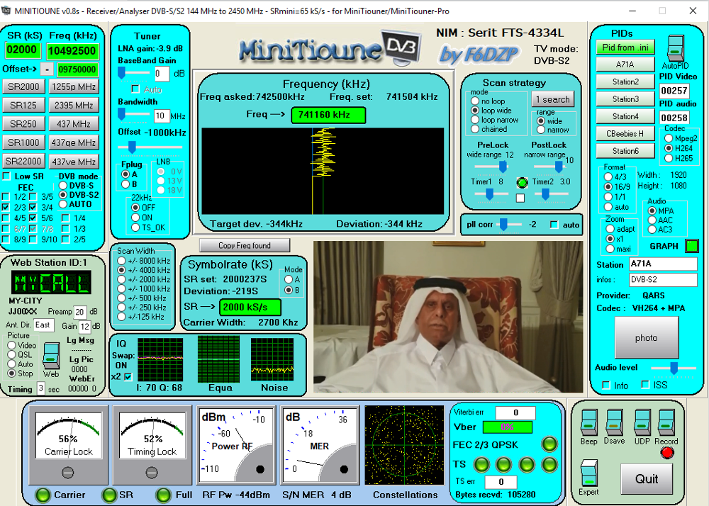

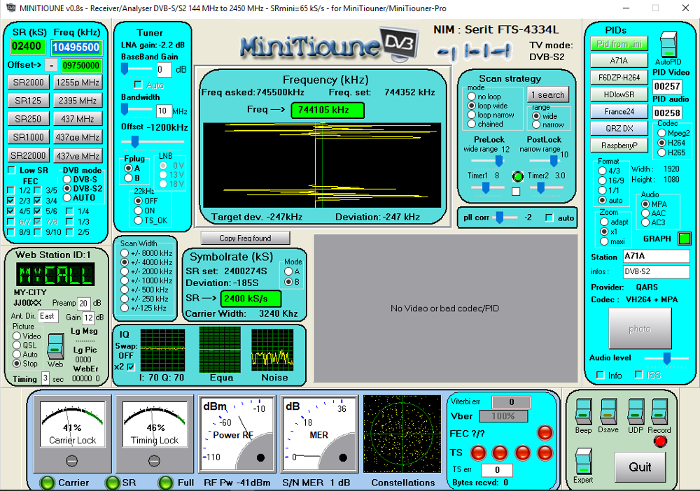

I'm using a 1m dish with Octagon OSLSO (DRO) LNB. Can receive the WB beacon no problem at MER 4dB. Small changes to azimuth and elevation don't improve this, so I think the dish is pointed as well I can manage.
The problem is I can't receive any other transmissions. I have tried for two days on a range of signals from 250kS up to 2.4MS. Most of the time I get no green lights at all. The best result has been on 1MS and 2.4MS signals where I get three greens, but no hint of TS lock.

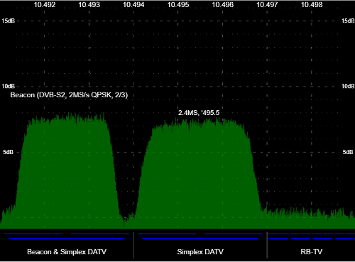

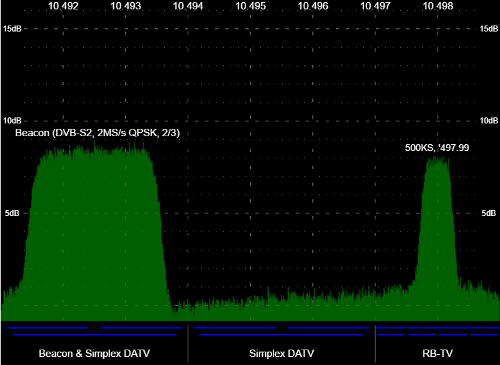

I've attached some screenshots of my MT settings and what the signals look like on SDR - they seem to be decently strong signals that lots of people in the chat are able to receive fine.

another thought just struck me when I had another look at your screenshots. The Rx frequency is in blue, until you hit the return key the previous frequency is still stored. Just a thought...hi
Malcolm

That was down to me tabbing between fields after entering ST and frequency. Tested with more signals and still no change.
