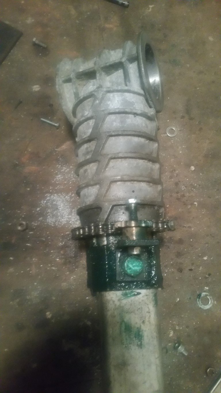

Its best to fabricate something it makes fine tuning so much easier, i use a large dish with a tight beam i fabricated this for it recently.

That looks like a casting which you have adapted. Very nice. If I get a bigger dish, I might need to think of something similar. The thing is that at present, I anticipate that my dish would be fixed on 26 East and so is it worth spending hours in the workshop making something to save perhaps an hours worth of fiddly setting up? May be when all my other projects are finished!

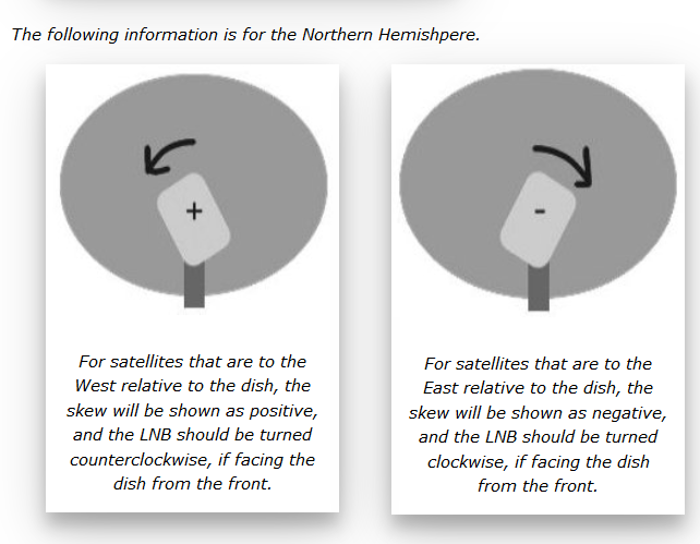

Newbie question - is that clockwise as seen looking into the dish from the front, or as seen looking at the satellite?

Clockwise from your point of view when facing the dish. But just adjust it for a small peak when the skew is optimised. On my set up it only about 2-3% of signal quality on the Satlink, but every 1% is worth having with this.

Hi Shaun yes its a casting from a old Paraclipse satellite dish its the H to H model, i am quite good at designing if you get a larger dish post a few pictures up of the fixing and i am sure i will be able to point you in the right direction if needed.

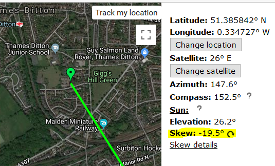

Hi Ray this should help providing i have the correct lat and longitude, on the LNB there should be a degree scale in your case this needs to be set to approximately -19.5 degree once the dish is aligned correctly try tweaking it a little.
https://www.dishpointer.eu/
