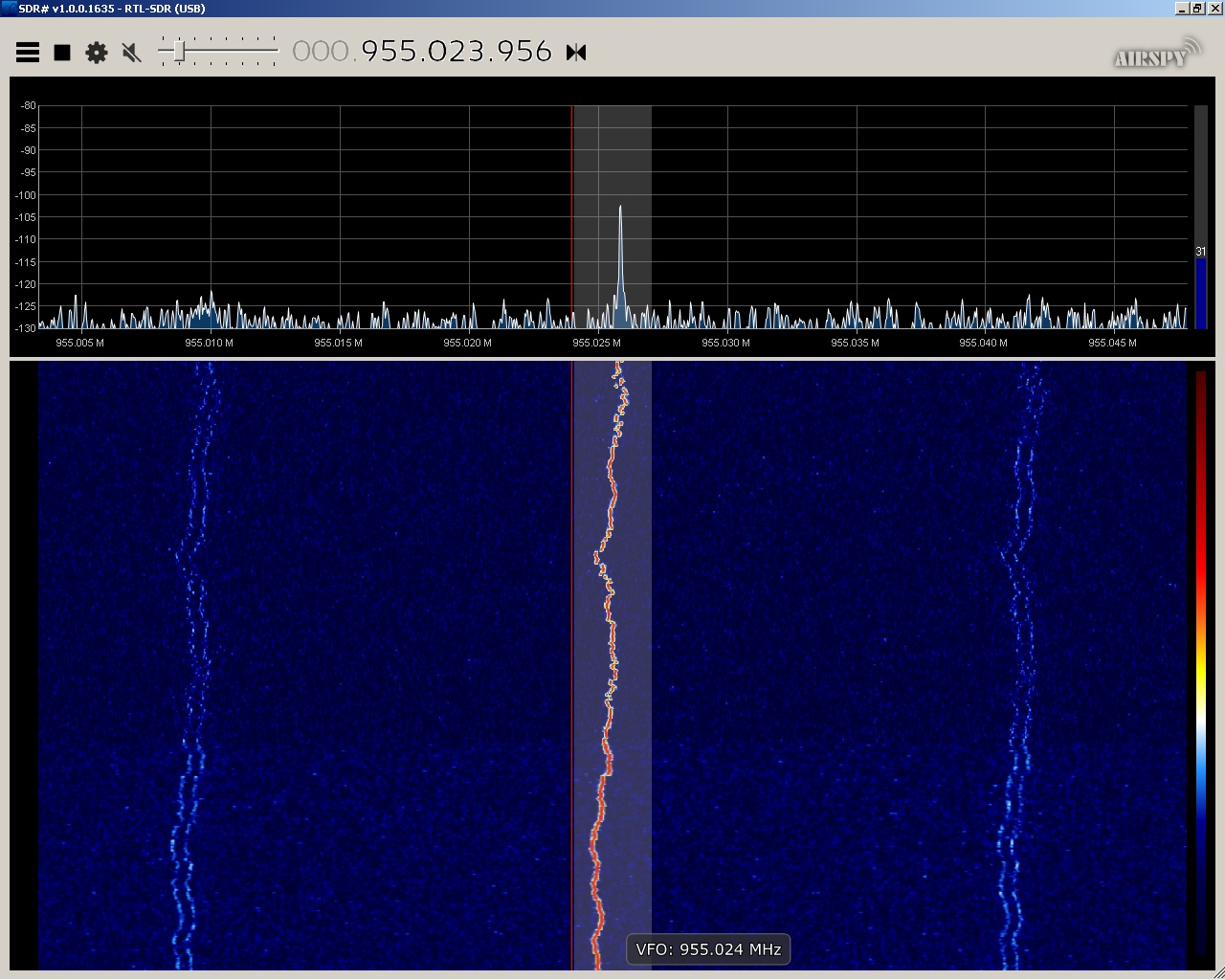

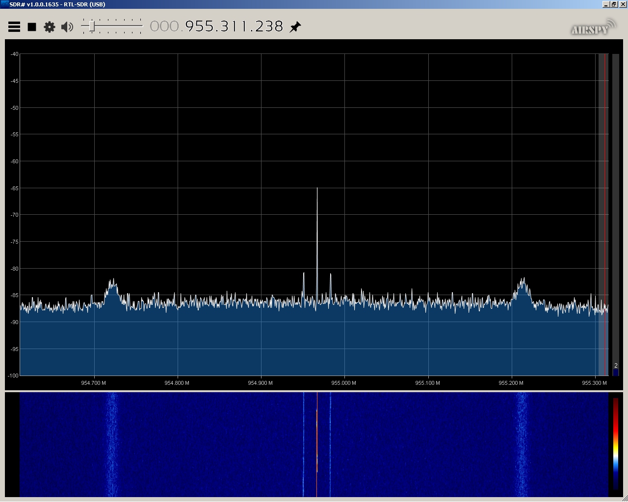

I can pick up the telemetry beacon from the sat on 10706MHz using just a 50cm offset dish, a .1db LNB and my SDR dongle.
It's about 25db above the noise floor.
I don't know how the signal level of this beacon will compare to those on the amateur transponder but at least it's a start.
I also have fed my scanner receiver set to Narrow FM and used this to adjust the dish for maximum quieting on the signal.
With my DRO LNB, if I leave it on for 30 minutes or so the oscillator drift is very little and a SSB signal may be resolvable with a little difficulty!
The top image shows a zoomed in scan (the grey area in the centre is a 3khz bandwidth setting.
Now to follow ES-HAIL as it moves to 26E and get a bigger dish!

Considering the satellite movement. If you look at N2YO.com, which has 'live' tracking data, you can see that the altitude is less than the nominal Geostationary one (roughly 35786km) and at the time of writing was noticeably decreasing with each minute. The effect of this is to increase the orbital angular velocity (by conservation of momentum) and the satellite will appear to move to the East relative to those at the nominal altitude. This orbital manoeuvre may explain why there is currently Ranging tone added to the Ku Beacon at 10706MHz, which can be seen as the 16kHz tones either side of the carrier in the picture above.
