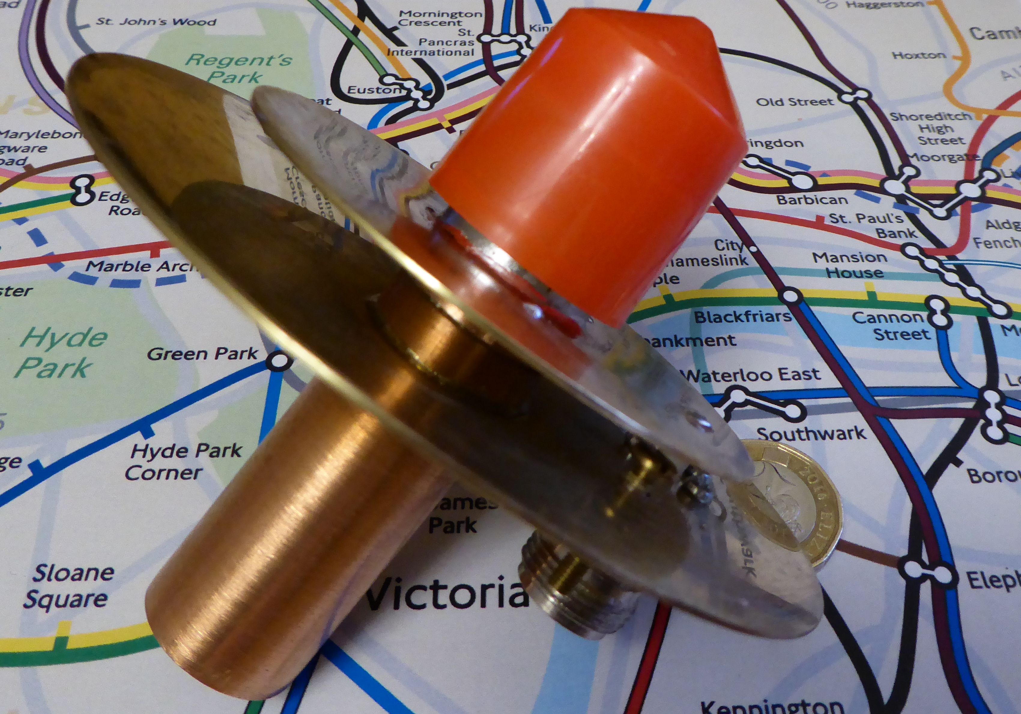

This afternoons project was a dual band feed based on DJ7GP design.

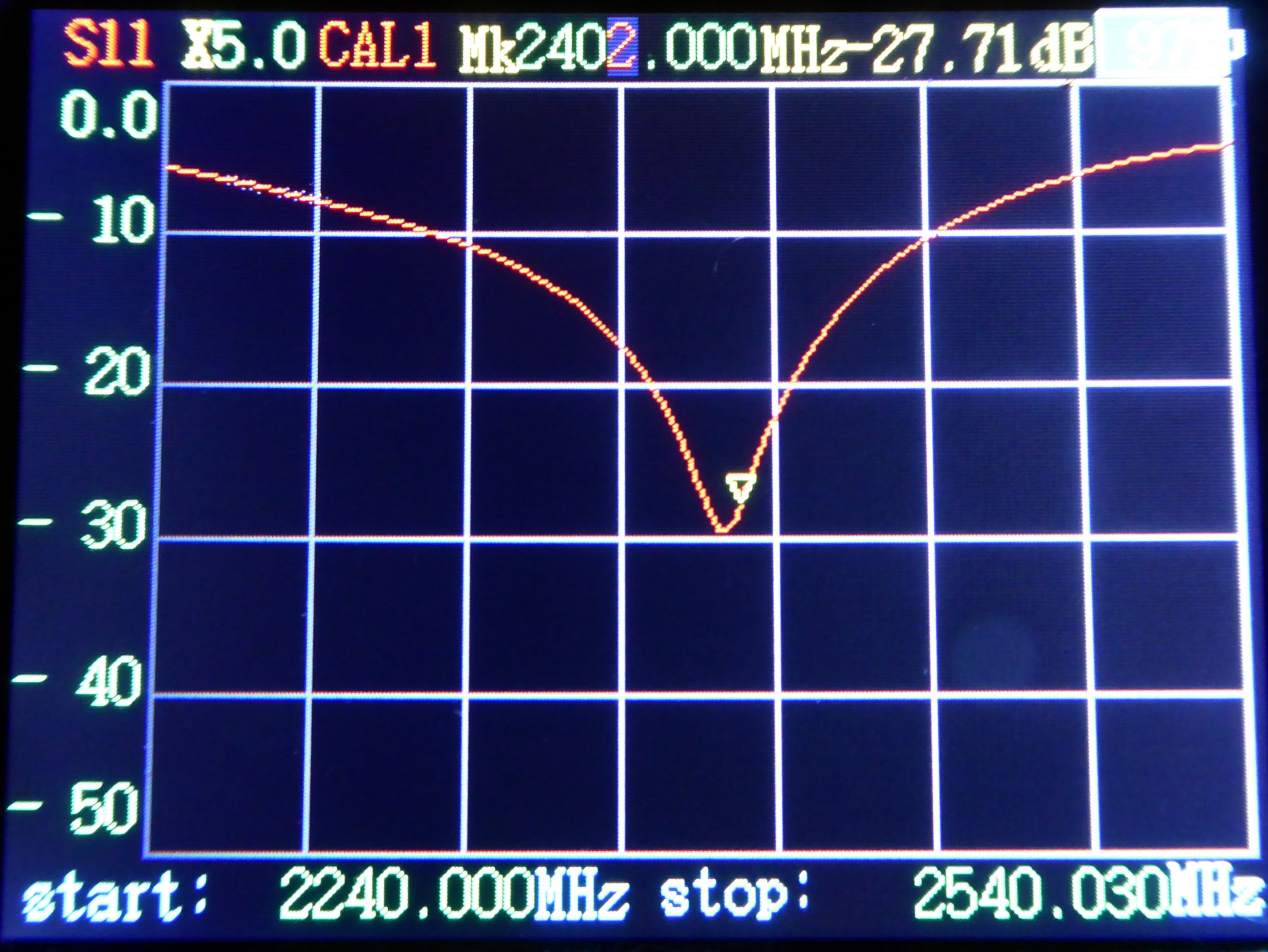

I am pleased with the match.
I won't know how well it actually works until I try it of course.

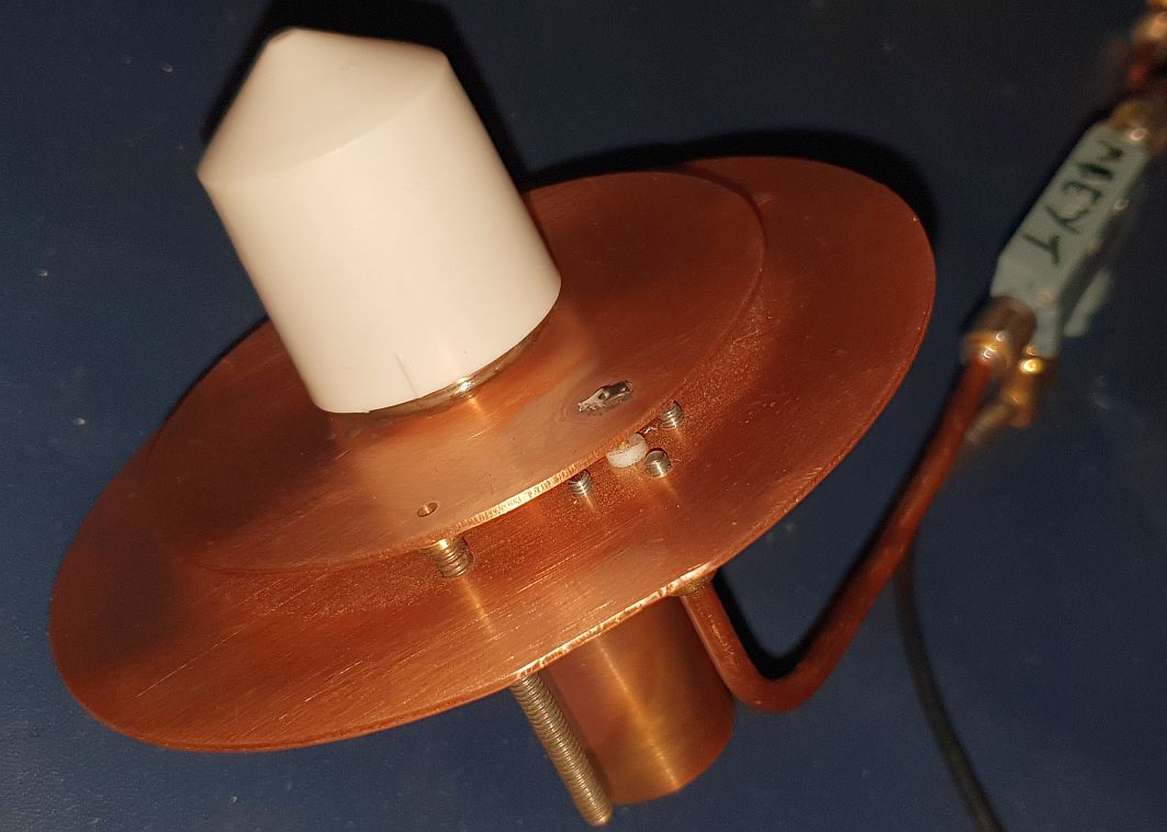

Here is my effort.
Response is pretty much identical to Mikes.
regards,
Paul EYT.
BTW I have the CAD files for this so its literally a 10 minute job to cut out the reflector / driven element.

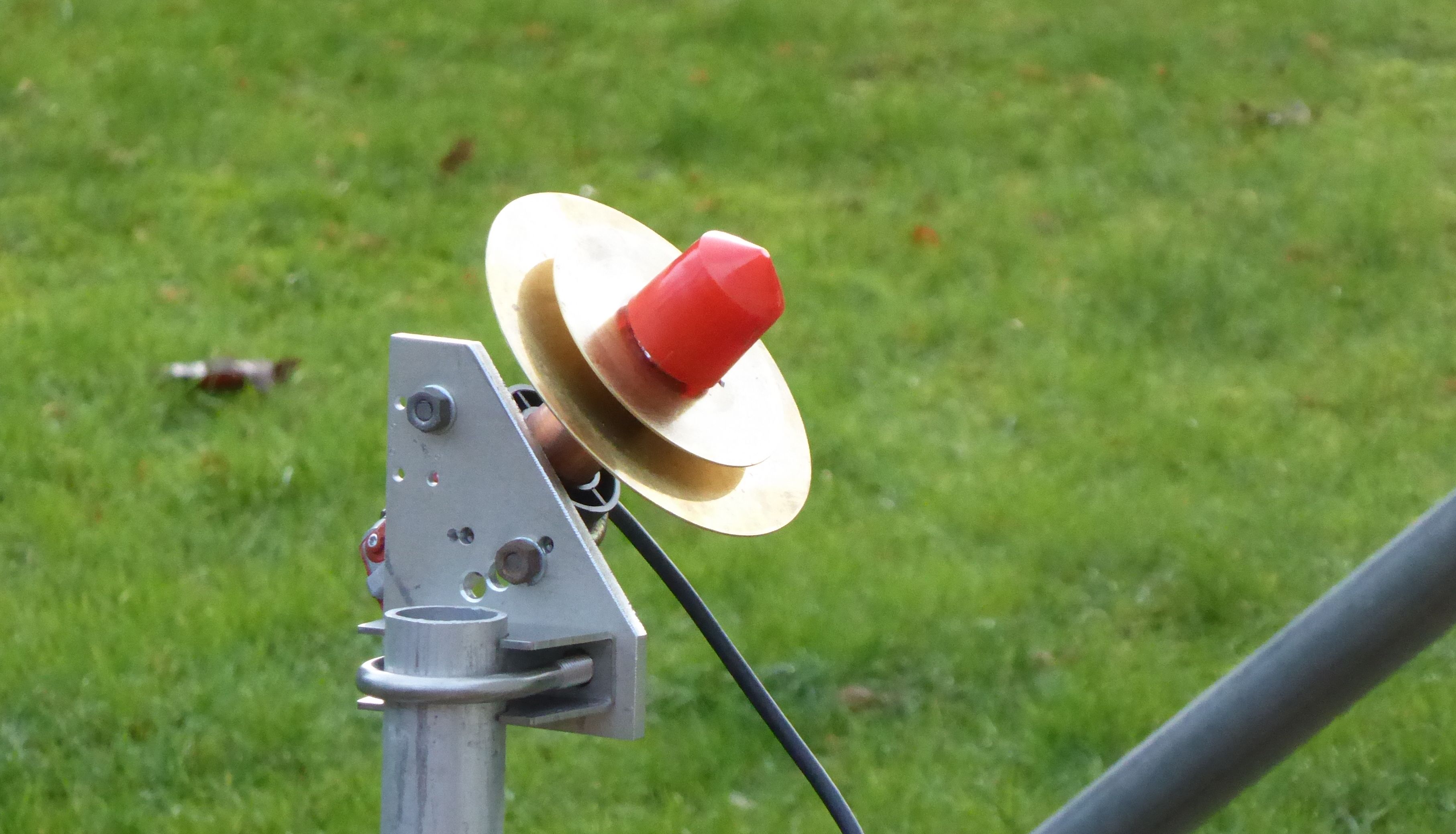

Yes - that's why it's there. I wish there was an easy way to get them without cannibalising a rocket LNB. Apparently some of these rocket LNBs have PLLs but not the ones I have received.
It seems to work - not too badly.
Just asking.. it looks completely different to the original design by DJ7GP. But he would know the details.

Post by g0mjw » Mon Dec 17, 2018 6:54 pm
How does it look different? It is the same design. He had a different dielectric lens I think but that's all.
