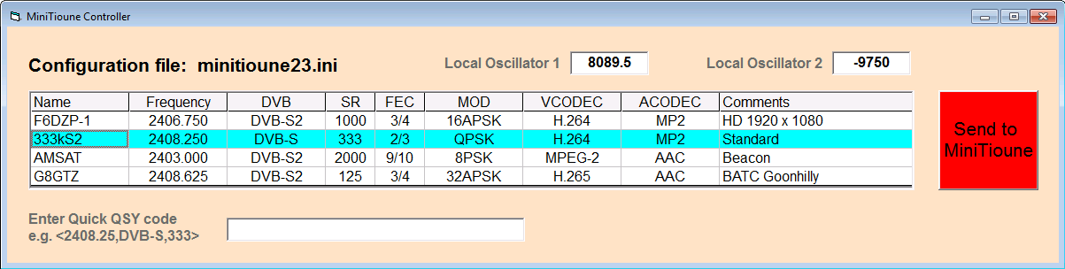

There are 20 channels in the recommended list for Es'hail-2. There will probably be other combinations as time goes on. To save having to remember them and to reduce QSY time, perhaps there could be a list of channels held in a separate control program that could communicate with MiniTioune. MiniTioune could listen on an IP port and change parameters as commanded.
On the chat system where people announce that they are transmitting and give their parameters, if they also list their parameters in a standard form such as <2408.250,DVB-S,333> this could be cut and pasted into the control program for a quick QSY.
You probably wouldn't need to send all the parameters from the table below, but there may be advantages in limiting the FECs and modulations that MiniTioune looks for.
It may be possible to have some sort of limited scanning facility, so that you don't miss anything.
When MiniTioune locks onto a signal, it could pass the parameters back to the control program, so that the table can be updated.
If MiniTioune could accept IP commands, it could be controlled from a remote location and the UDP output of MiniTioune could be sent to the remote location. You could leave MiniTioune running while you were at work and let someone in Australia experience Es'Hail-2. Obviously there are lots of considerations, not least security, but it should be technically possible.
Perhaps when you make your MiniTioune externally available, it could log into a BATC server which could allocate your MiniTioune to a remote user on request, via a BATC login.

yes you can, but before Brian began this post we have discussed about that. He wished to be able to talk to Minitioune using DDE or someting like that and I have proposed to use IP:
Brian asked:
>>>The simplest solution would be for MiniTioune to listen for a command, maybe using DDE, which says 'read from minitiouneXXX.ini and restart'.
my answer was:
OK for the possibility of parameters transfer, but I think that the best way is using IP. That would allow to use external PC or Rpi to send the parameters and can be done also on the same PC. And we will not be obliged to restart Minitioune.
Brian asked:
>>>but it might be useful for MiniTioune to send back to the controlling program, the FEC, modulation and other parameters that it had detected.
my answer was:
Minitioune already send all information to the Tiounemonitor. I have just to add a local IP/port to send also the information to another software.
