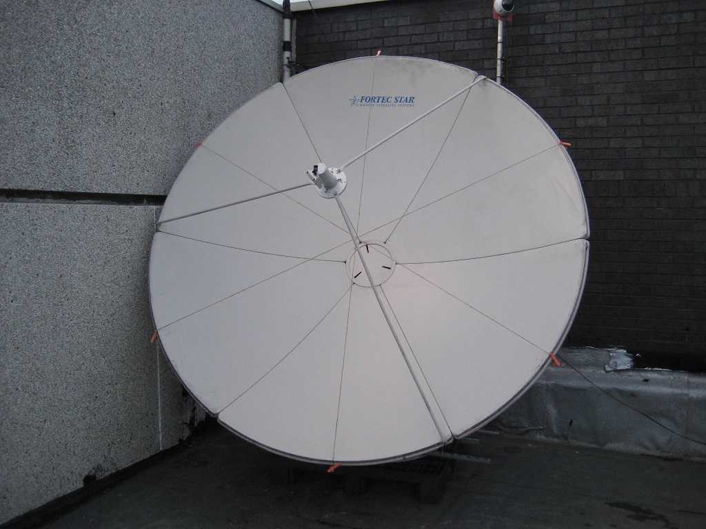

I'm setting up a 2.4m dish on C-band that will eventually be used for the uplink. I don't have anything to compare it with, so I wonder if someone could look at 10E, 3689L, SR1083, DVB-S2 and see what they get please.

The dish isn't very movable and pointing it is a bit hit and miss, so the stronger the transponder the better. There's only one transponder at 26E and it looks like it's a lot weaker.
It's just getting the hang of several new things: lower frequency, big dish, prime focus, big LNB, scalar rings, circular polarisation. If it looks optimum at 3.7GHz then it should be fine for 2.4GHz with a helical feed or patch.
Lyngsat shows C/N figures for each transponder, but I don't have a feel for how that might translate to MER values.
The 2.4m will be for uplink only. We'll be using a 1.2m for receive.

I used that method to try out the 1.2m Channelmaster that will be used for receive. It's hard to miss Astra.
The 6 petal Fortec Star dish that we're using at G3NWR doesn't have a very good reputation: poor geometry, fragile and rust prone, to name a few. It's particularly not recommended for 10GHz, but people are getting reasonable results from them on 3.7GHz, so 2.4GHz should be even better.
The main attraction is that they cost one tenth of the price of a 'good' one, if you can still get them. There's a 2.4m version of the Channelmaster going for £2300 second hand on Ebay.

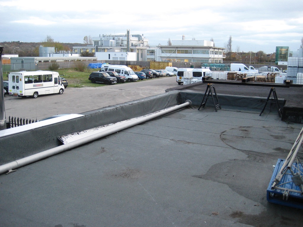

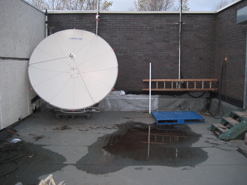

The dish still has the strings across it to check the geometry. It's within a few mm. It should be fairly well shielded from the wind and the takeoff to 26E is good.
