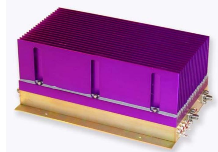

Meanwhile, there are other options - Stealth Microwave do a range of highly linear amplifiers and people will be very familiar with the 20W 3.4GHz units with the purple heatsinks that were widely available surplus a year or two ago. So available I remember the box containing 2 of them, with PSUs were going for £5 to £10 at Didcot last year. There were also 50W units but these were much rarer.
Anyway, they also made identical looking amplifiers covering 2.4 GHz. The trick to identification is to understand the model number - e.g. SM3437-43 is an amplifier covering 3.4-3.7GHz at 43 dBm (20W). The SM2325-47 covers 2.3-2.5GHz at 47 dBm (50W) and there is a 44dBm (25W) model. They do appear, from time to time at Rallies and on Ebay.
