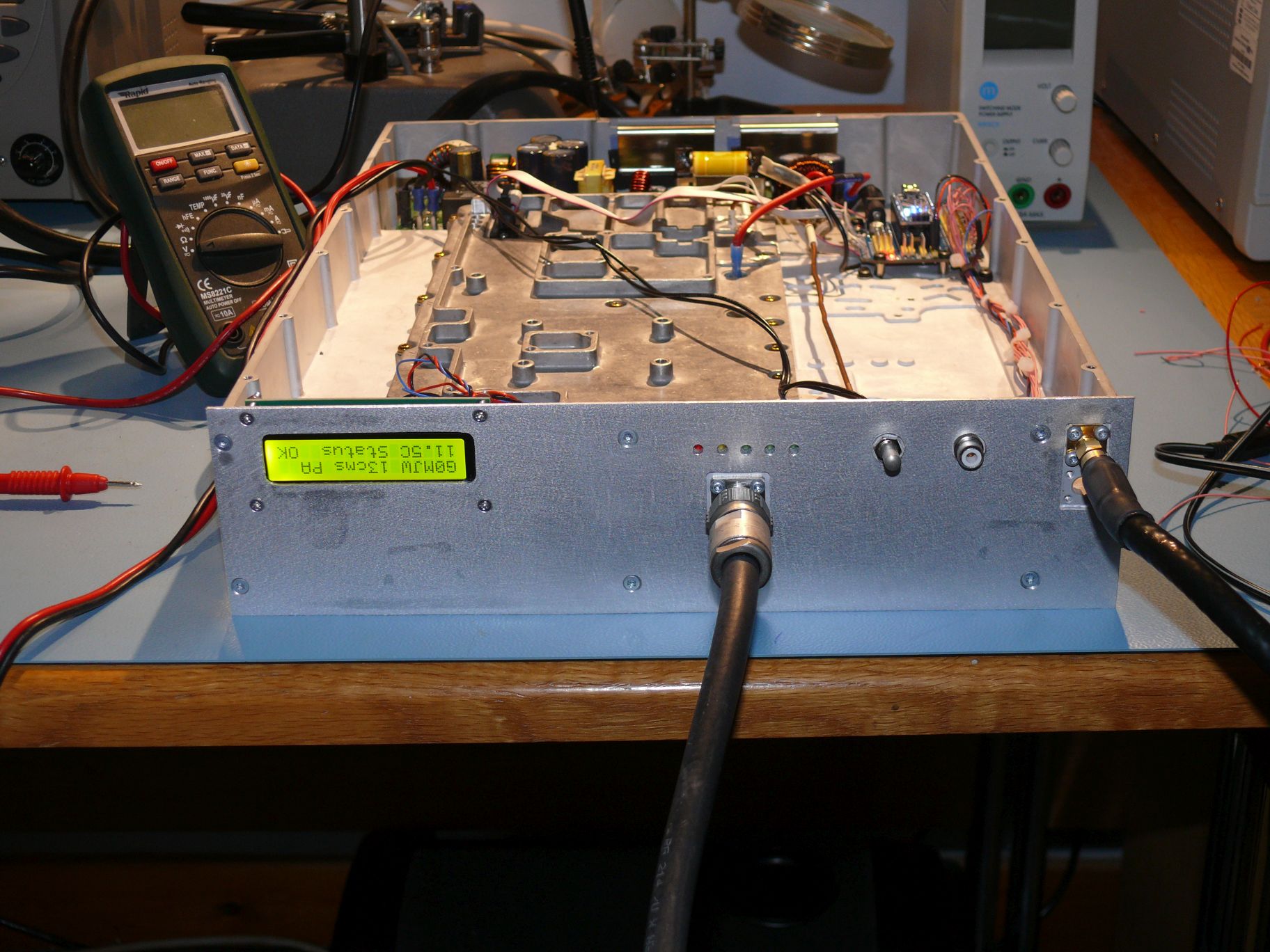

I wrote an article on modifying these using an Arduino Nano to provide diagnostics and protection.

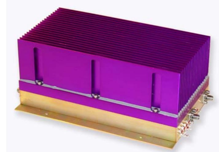

However, these amplifiers are for 2.1 GHz and going to 2.3 GHz, without modification of the RF matching was already pushing it. Going up to 2.4GHz is maybe pushing too far, untested. That does not mean it won't work, but it is likely to work a lot better with some retuning. The good news is they run off -48V so you can use a standard telecoms supply, but also the internal system is 28V which might be better as the existing PSU is a limiting factor for CW output. If you want to operate well backed off for DATV, its fine as it is. I also have a spare in my garage.
Meanwhile, there are other options - Stealth Microwave do a range of highly linear amplifiers and people will be very familiar with the 20W 3.4GHz units with the purple heatsinks that were widely available surplus a year or two ago. So available I remember the box containing 2 of them, with PSUs were going for £5 to £10 at Didcot last year. There were also 50W units but these were much rarer.
Anyway, they also made identical looking amplifiers covering 2.4 GHz. The trick to identification is to understand the model number - e.g. SM3437-43 is an amplifier covering 3.4-3.7GHz at 43 dBm (20W). The SM2325-47 covers 2.3-2.5GHz at 47 dBm (50W) and there is a 44dBm (25W) model. They do appear, from time to time at Rallies and on Ebay.
