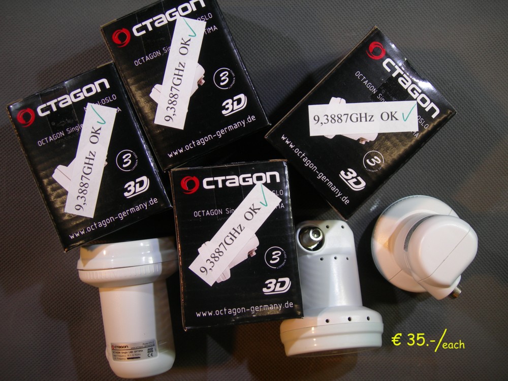

For the satellite reception.... PLL LNB
- DSCN8878x.jpg (190.18 KiB) Viewed 29506 times

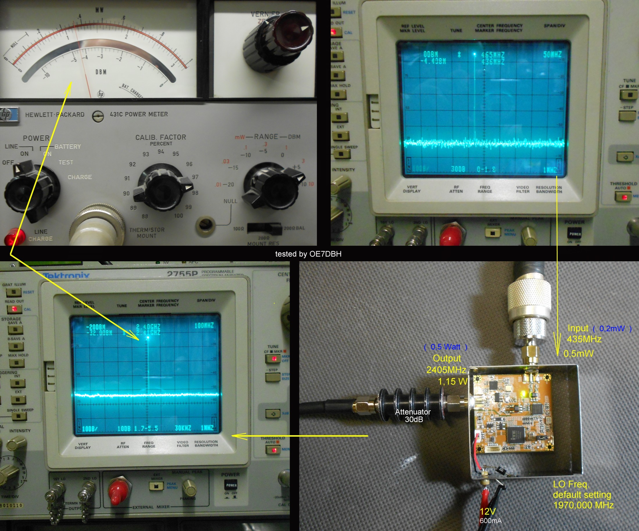

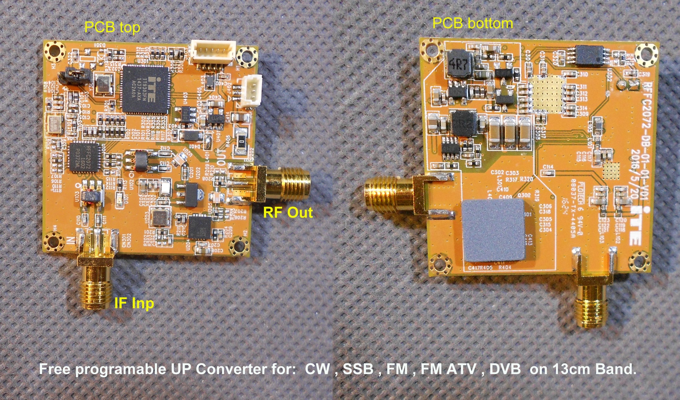

- 1.jpg (938.38 KiB) Viewed 29506 times
for DVB , CW and SSB signals....
- 3.jpg (785.9 KiB) Viewed 29506 times

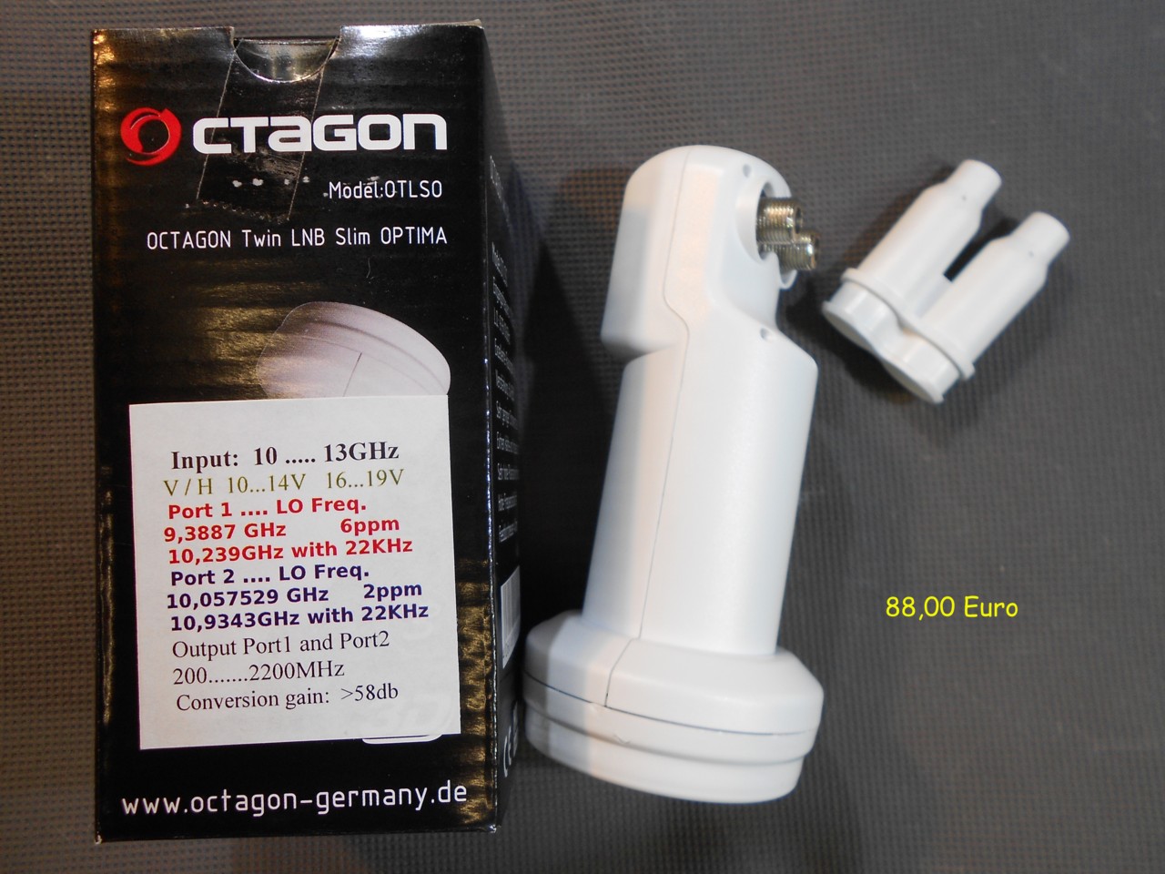

...another one LNC for receiving :
Output1 or Port1 for DVB-S
Output2 or Port2 for SSB - CW on 70cm Band
- Twin20LNC.jpg (289.29 KiB) Viewed 29271 times
88,00 Euro kit including: LNB , T bias , Adapter F male to BNC female

Input Drive Level?
On the image showing the DUT hooked into an analyser the drive level is shown as 0.5mW which is about -3dBm.
However the drive on V1 and V2 is -10dBm which is 0.1mW and the drive on V3 is +10dBm which is 10mW.
Was the original DUT being over driven or under driven I wonder.
The output of a FT818 is about 6W call it 38 dBm. (We all forget to switch the power down at some point!)
a 30dB attenuator will therefore be required to drive the v 3 unit .
I think my Maths is correct.
Picture above shows the inner one of the first prototypes, with more than allowed input Levels ( without Input attenuator and 0,5mW Signal ). Nevertheless clean output signal.
We have a head on our shoulders to think about that
a 30dB attenuator will therefore be required to drive the v 3 unit for SSB-CW
YES
For digital Television: attenuator value depends on TX output signal Level , there are two versions UPconverter available

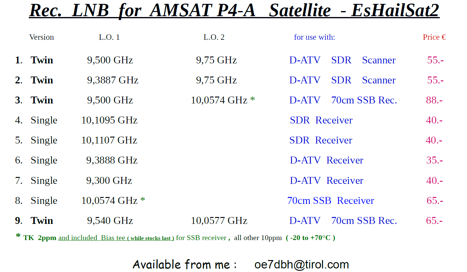

10GHz Octagon down converter...
- LNB liste batc.png (135.52 KiB) Viewed 25233 times

TCXO at 2ppm, 10ppm normally? That means 20kHz to 100kHz error. OK for DATV but we are going to need a lot better stability for SSB/CW than 2ppm. Any way to develop an LNB for 10 GHz that takes a 10MHz reference input?
Re: Hardware for EsHailSat2
Posted: Fri Sep 28, 2018 9:01 am
by YL3AKC
g0mjw wrote: ↑Fri Sep 28, 2018 8:05 am
Even if I am lazy, I am working on this...
