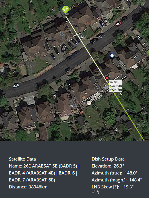

Post by radiogareth » Sun Jan 20, 2019 5:23 pm
I thank the gods of house purchase from 25 years ago. I have a ground level accessible brick wall with this line of sight over my single story kitchen/garage extension.
Sat dish.PNG (654.73 KiB) Viewed 8320 times
I have an old Bob Platts LNB with a 0.6 NF and a 9.0GHz dro, along with a 65cm Maspro solid offset dish, also an Octagon PLL dual output to try. This gives an nice short run of coax/cables to the shack and also the opportunity to mount a bigger dish for uplink some day. I have a 40 element Loop-yagi gifted from a friend who used to use it for the Oscars. Will that better a 1M dish I wonder?

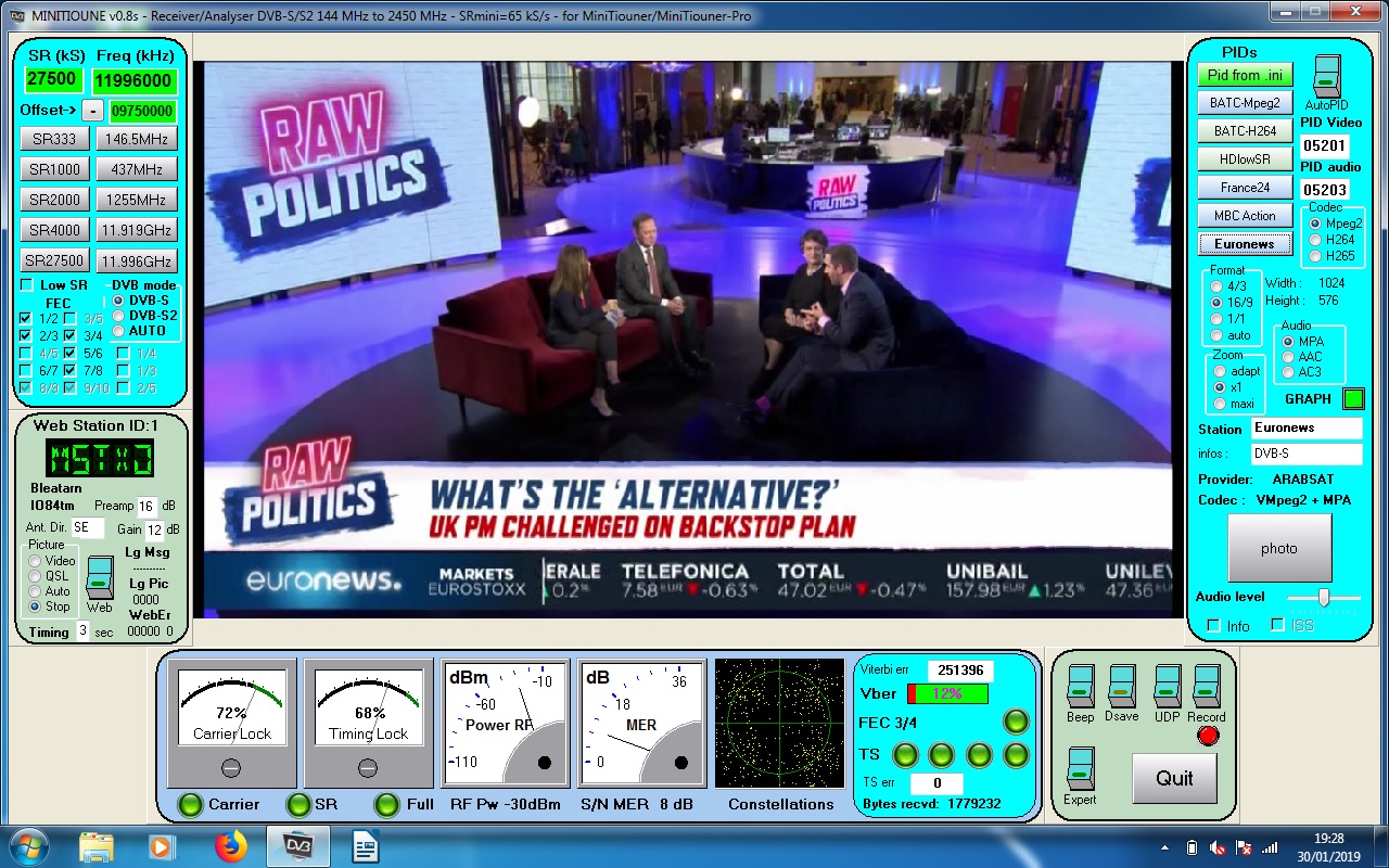

Post by M5TXJ » Wed Jan 30, 2019 7:23 pm
I've lined up my dish using Euronews on 11996MHz H, 27,500KS/s, FEC 3/4, Vpid 5201, Apid 5203. With an Octagon OSLO on a 1m dish minitioune shows -30dBm and 8dB MER. Hope that helps.
73 Dave.
