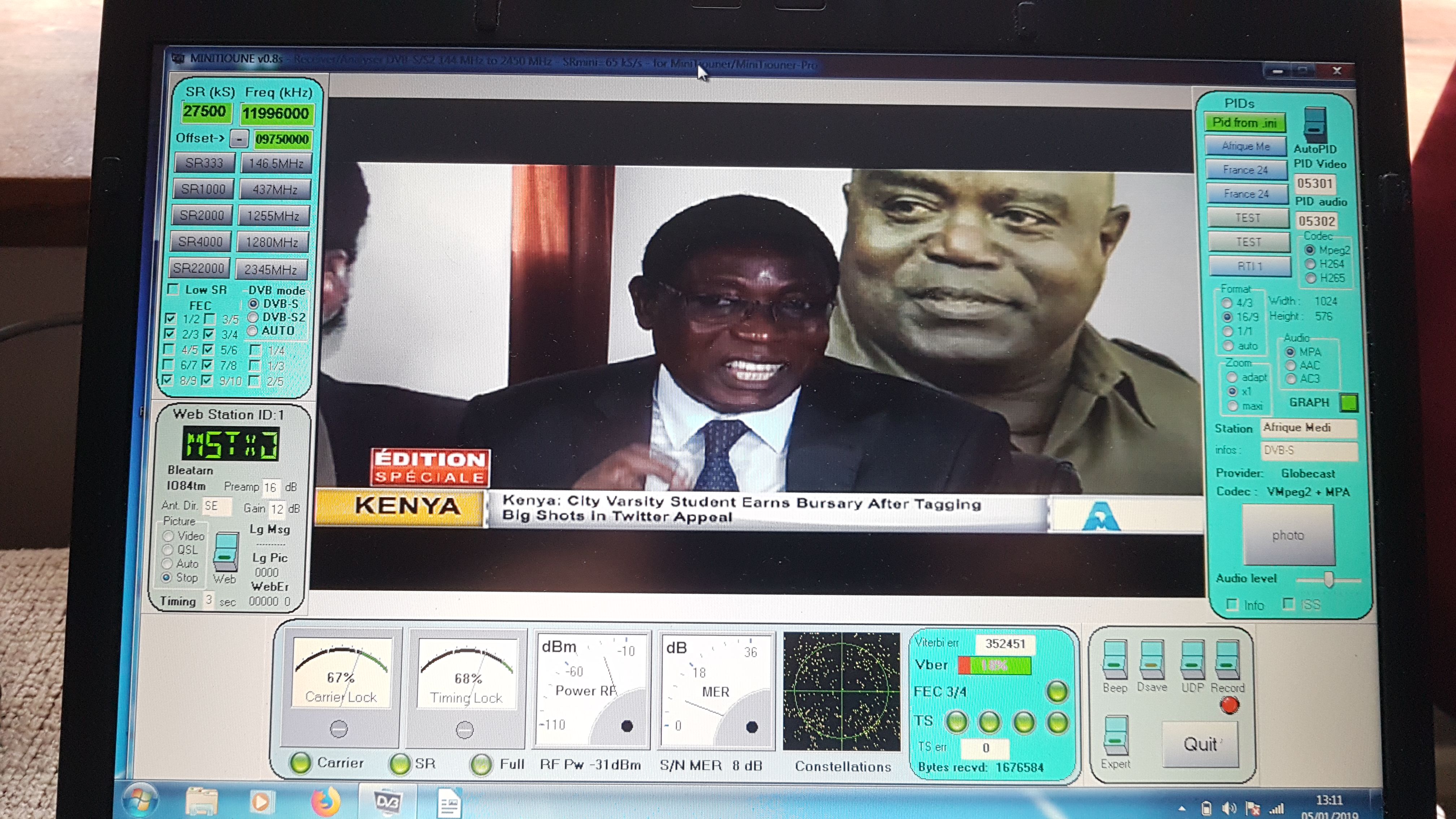

Got my 1m dish aligned on BADR-4 this afternoon. Not quite as good signals as some people have but I can tweak when I have a second pair of eyes to give feedback, up and down the ladder isn't the best way to go.
73 Dave

That's pretty good for a 1m dish

You may find the easiest way to do the final tweak is to use the beacon on 10706 MHz.
You can receive it on an RTL dongle and any SDR program or a scanner / wideband rx tuned to 956MHz, switch to NBFM and it should be in smoothish noise, just right for final tweaks...
