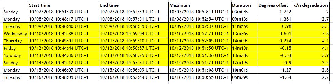

During this week, as with every equinox, the sun passes through the same position in the sky as a given satellite – using this website https://www.satellite-calculations.com/ ... erence.php you can calculate when the sun will be in the same position as BADR4 for your location.
So long as it is sunny this week (Tuesday and Wednesday look excellent), you will be able to see where to place your dish by seeing where there is direct sunlight - suggest you take some pictures so you can put the dish up later.
These are the times and dates for IO91KF (times are in Local BST)
This, along with a lot of other information on Es'hail-2, will be in CQ-TV due out this week.

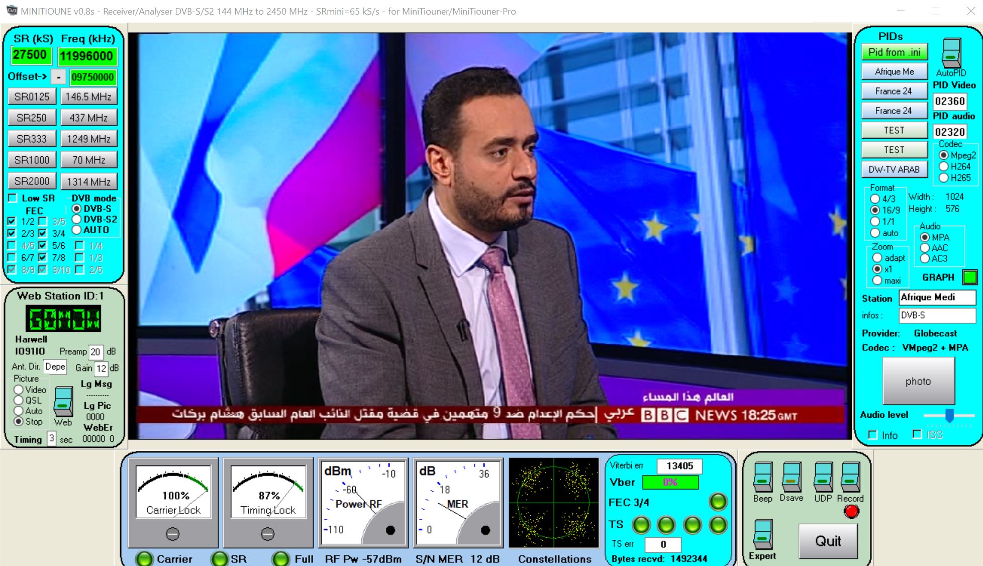

Post by g0mjw » Wed Nov 21, 2018 7:40 am
That's good. I had about the same, a bit better perhaps with a 1.2m dish. With my as yet un-optimised 2.4m dish I get 12 dB MER. There are trees just about in the way. Graham, who owns a chainsaw, gets 13dB with a 1.8m dish. Given the 1.8m dish has 6dB more gain and half the beamwidth you have a good result. The main issue is more likely to be interference from adjacent high power signals from 28E rather than signal strength. Your -10dB beamwidth should be about 3.5 degrees and 2.2 degrees away there will be significant rejection, but the signals from 2 degrees away are stronger. In Northern Ireland the numbers will be different to Oxfordshire.
26E Badr ~46dBW EIRP,
28.2E Astra 54 dBW EIRP (2.2 degrees away)
23.5E Astra 3B 51 dBW (2.5 degrees away
A 60cm dish will only have 10dB rejection to these adjacent satellites so interference will be severe and it might be difficult to pick out. However, it depends on how the transponders on the adjacent satellites are configured and if there is any additional cross-polarisation rejection.
Perhaps someone with the time can do an analysis?
At 10.5GHz, there are no adjacent signals (yet) so hopefully smaller dishes will be fine.
