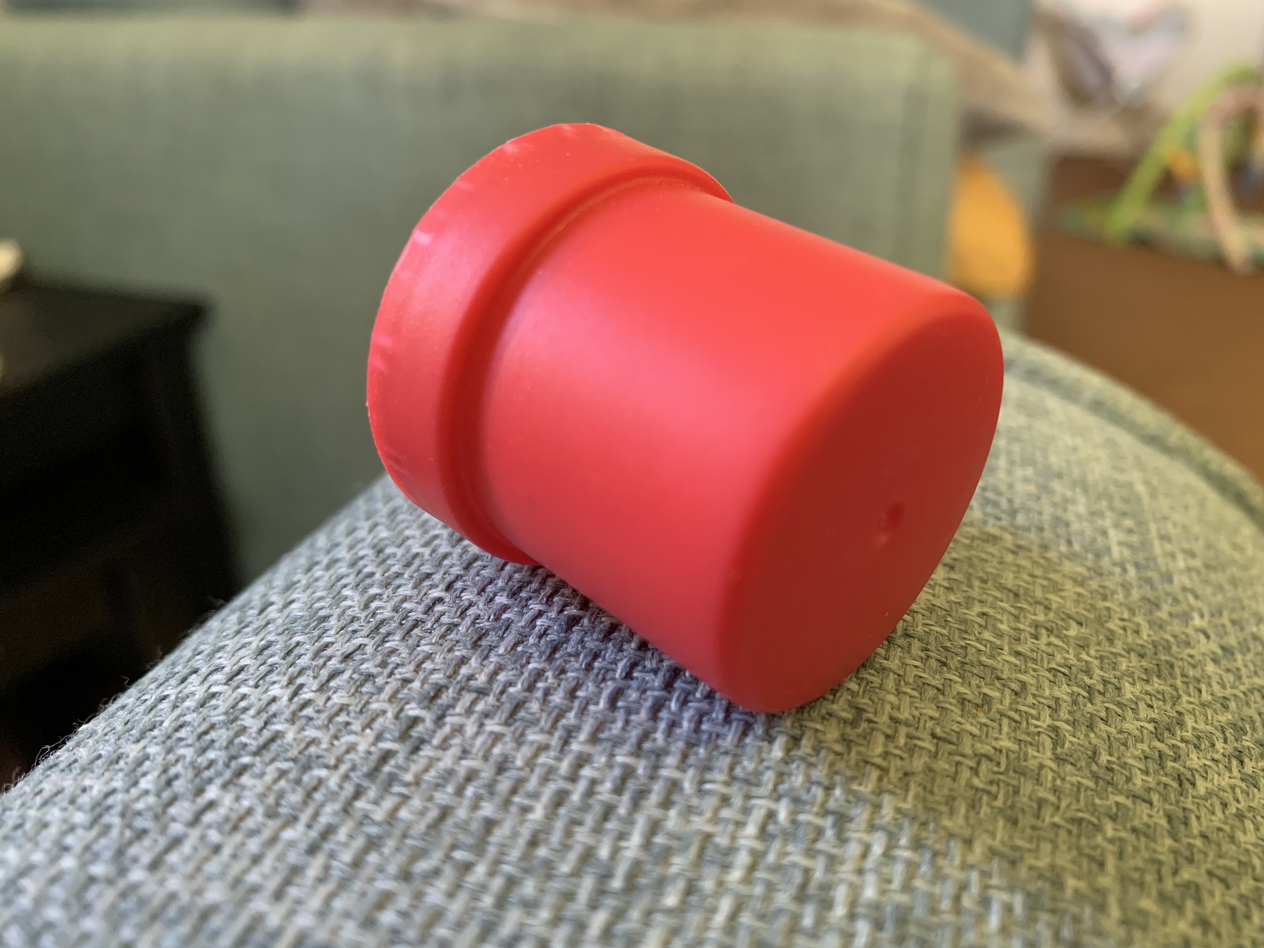

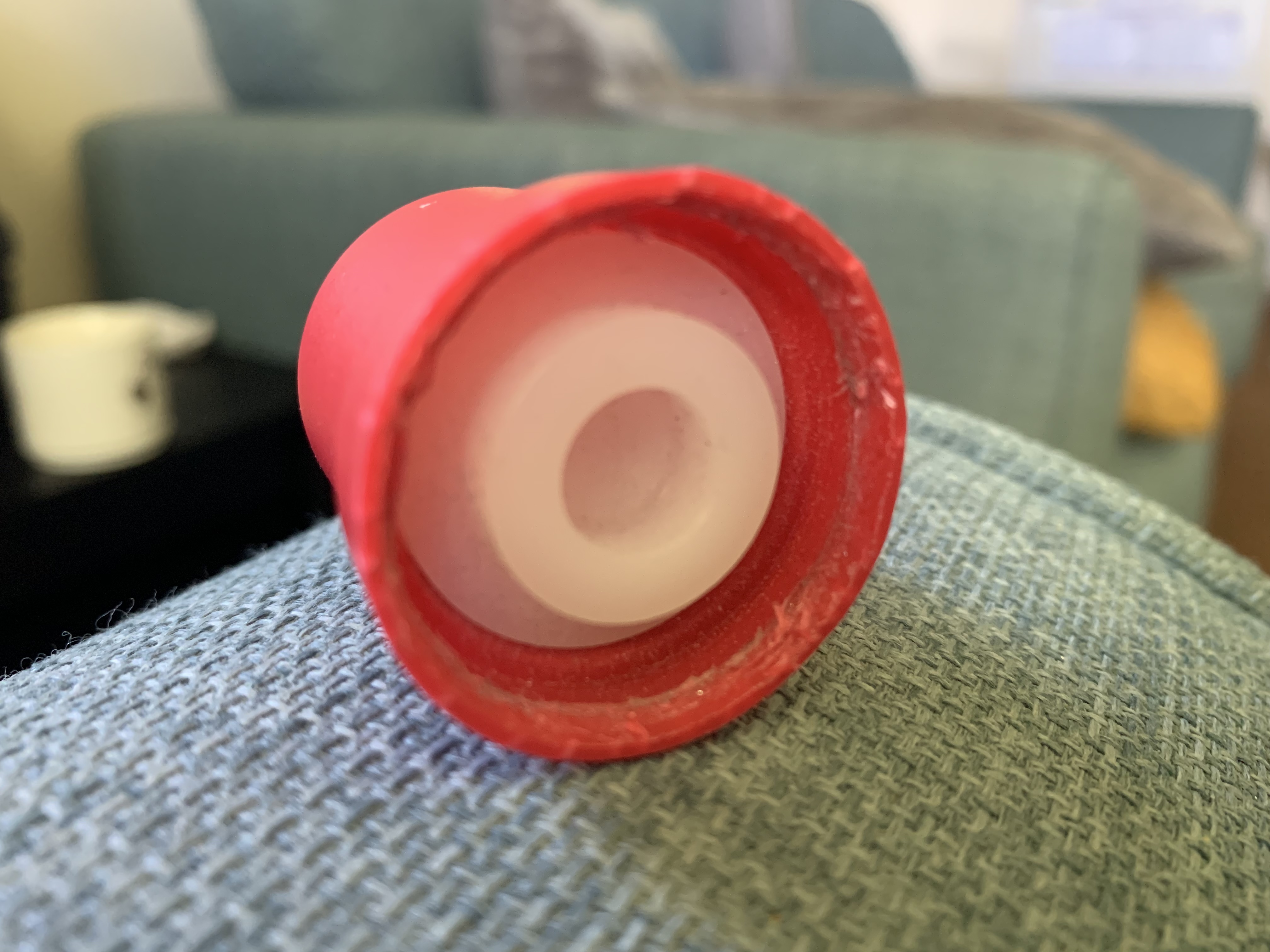

Ok, now I’m confused. Both Mike and Noel (who has seen the actual lens I have) have both have said that what I have is ‘the one I need’...
However, on re-reading Mike’s post (above), it mentions “two pieces that slot together” - mine is a ‘single’ piece (well, ok it’s a red outer shell with white insides, but they seem to be bonded together).
I’ll try to attach a couple of pics of one slightly damaged one so you can see what I mean.
The other thing is that it doesn’t fit on the end of 22mm pipe - the internal diameter of the red bit is too big. It is, however a reasonably good fit into 28mm copper pipe.
All comments and suggestions welcome.
John M
Rear view
Rear view
Front view
Front view
G8PEF
Posts: 176
Re: Which rocket lens ?
Post by G8PEF » Wed May 15, 2019 10:05 am
Ah! I have just managed to get the white bit out of the red shell. The inner appears to be just a cylindrical white block (polyethylene?) apart from the single machined/moulded ring on the end facing the waveguide, visible in the photos above.
Comments welcomed.
J
Posts: 2740
Post by g0mjw » Wed May 15, 2019 10:10 am
Never seen one of those - but its still a lens so stick it on the end of the waveguide as best you can and see if it works.
