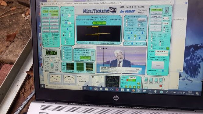

Post by G1BVI » Tue Sep 11, 2018 6:30 pm
Sorrt for inverted image.
What ever I do to source it still inverts here?
Nick

Post by g0mjw » Tue Sep 11, 2018 6:51 pm
Nick
That's odd.
Probably some metadata in the properties. IrfanView fixed it.

Post by G1BVI » Tue Sep 11, 2018 8:14 pm
Thanks Mike
Re: Es HailSat 2 location
Post by g8gtz » Wed Sep 12, 2018 8:01 am
Taken on an iphone?
Open it using any windows app (including picture viewer) - it may appear right way round but save it anyway and it will then be OK.
