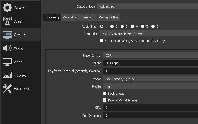

I confirm that with an Nvidia recent graphic card I can use the Nvenc (Nvidia encoder) H264 as can be seen on the screen shot
Driver for the video card must be the latest
My configuration is PC Win64 with Nvidia GTX1050Ti graphic card
In Nvidia Control Panel I have choosen "use GTX graphic card for all usage" instead of using the standard Intel GPU

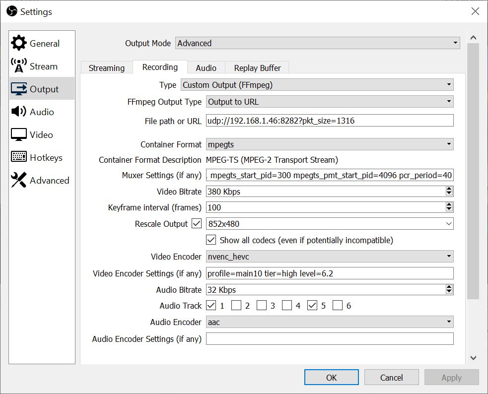

I use H264 for streaming OBS to Pluto with F5OEO firmware and I use H265 (nvenc_hevc) to stream OBS via UDP to DVBSDR on Raspberry + Lime
See other screen shot
So my CPU is not overloaded, my Nvidia GPU does the job of encoding !
Nvenc_H264
Nvenc_H264
Nvenc H264.JPG (37.96 KiB) Viewed 7008 times
Nvenc_hevc
Nvenc_hevc

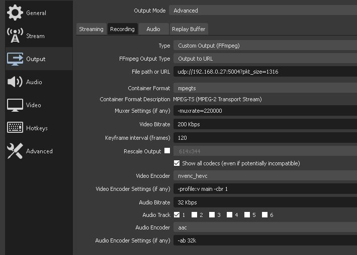

Posts: 2740
Re: Latency improvements ?
Post by g0mjw » Tue Oct 29, 2019 8:22 am
Hello Alain
That's what I was doing last night, but it's rather unreliable. I think this may be a network problem. However when it does work the H265 CBR is not very well constrained. H264 is much better. The result is that with H265 you can only set about 50-60% of the available video bandwidth, depending on picture content, before you start to get timing errors. This negates much of the efficiency advantage of H265. I think we might be able to find better settings, but there are many variables so that's going to take a while.
This is just on the threshold of not working with 333ks 3/4 rate 8PSK so there should be 740kb/s for the video, audio and overheads.
For QPSK the TS rate is 495kb/s and highest reliable video rate I found to be about 220kb/s with 32kb/s audio. Any higher and there are errors and audio dropouts. It might be possible to do better with the slower encoders. That's something to be tested.
