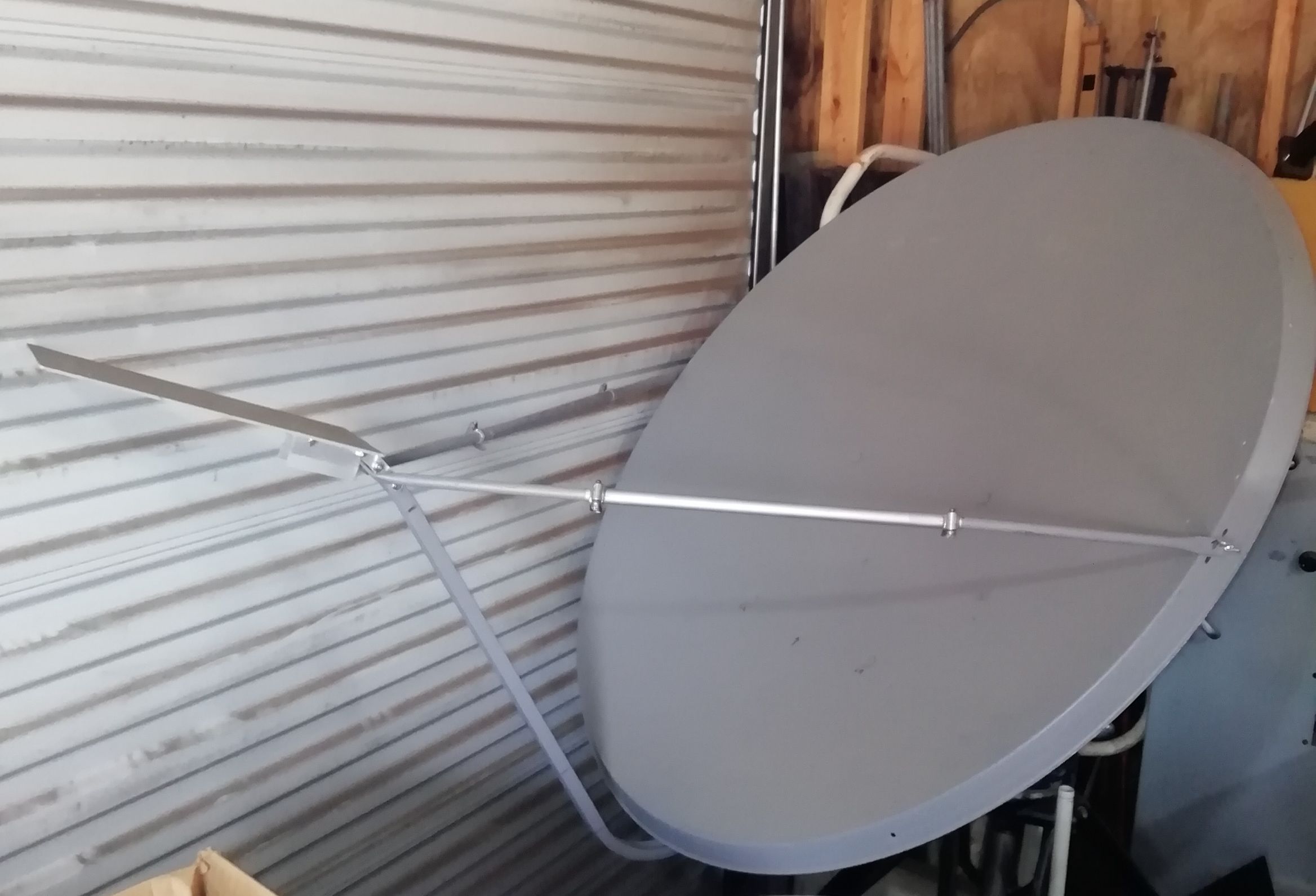

You are right, threaded rods are available and not so expensive, and not only in 1m sizes but also 2m are available. Unfortunately threaded rods are bending easily at 1m lengths even if they are 8mm.
For CM 1.2m antenna, to be able properly install dualfeed LNB sidearms >than 1m are needed (something like 1.2m).

As for replacement arms I suspect tubing would be preferable if only for weight reasons, plus tubing might be more rigid ?

@G4WIM Yes, tubed feedarms are lighter and more rigid as well. Comparing to original feedarms and holder, feedarms made of 10mm tube plus all fittings weight is almost 200 grams less. ImageImage

I used the tube approach on my winegard dish for eme , which proved strong enough to support a twt at the feedpoint!
