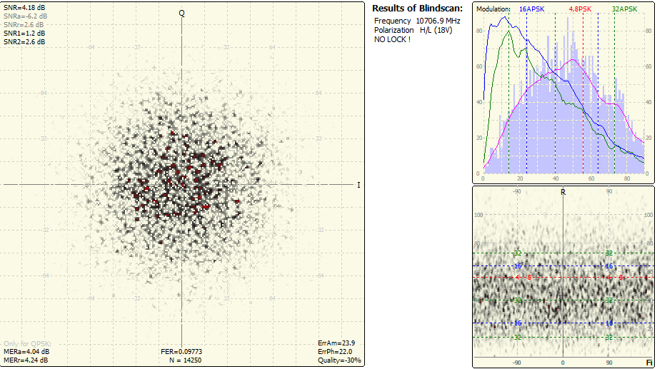

Post by satdxer » Sat Jan 26, 2019 10:22 pm
Hi i am only seeing 10706 H from my location in Sheffield 1.2 dish.
10706 H.PNG (106.23 KiB) Viewed 6635 times

Post by g3zgz » Sun Jan 27, 2019 7:46 am
I was using H polarisation and can just see a signal in the waterfall.
Today I'll check my dish alignement as we have had strong winds here in Blackpool.
OK about the strength of the beacons - it will be interesting to see how they compare to the downlink signals.
