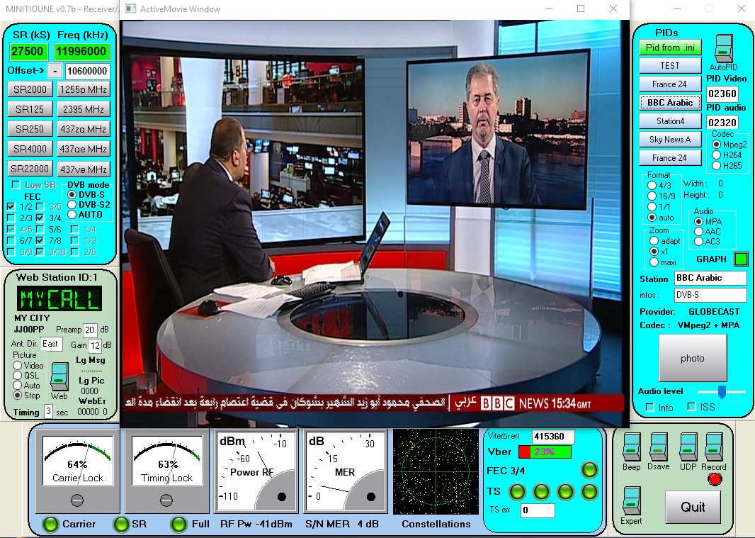

As you seemed quite upset I thought I had better try myself. I had to start by installing a dish so it took a while but here you are:
Hope this helps with the settings. The problem might be lack of 22kHz or perhaps LNB is taking more current than expected and the Polyfuse is activating.
I am having to operate the tuner above 2 GHz as I don't have a 22kHz tone injection, this is 11996MHz. H/V is 19V but also easily fixed by rotating the LNB 90 degrees. I have not optimised this too well, the signals from 28.2 degrees are so strong it is hard to find BADIR, however, they are also a useful marker. Line up on that enormous signal and move 2 degrees to the West.

I set up my Mini Tiouner as per your set up running the tuner from 12V.
I twisted the LNB and Eureka BADR.
The MER like you is also quite low.
I have an 80 cm dish and this is fitted with a 0,1 dB LNB.
I will try and fine tune this weekend but think its just about alligned now,
Elevation was very critical.
