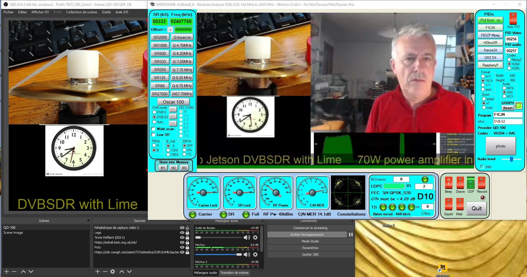

I am testing OBS to UDP to Jetson Nano to Lime (without ffmpeg).
The total delay (transmitter and Minitiouner receiver) is around 3 seconds total (see the clocks on the images).
It works but the image quality has to be improved.
73's
Alain F1CJN
image error : I updated the image because I am in recording mode for UDP in OBS (and not streaming).

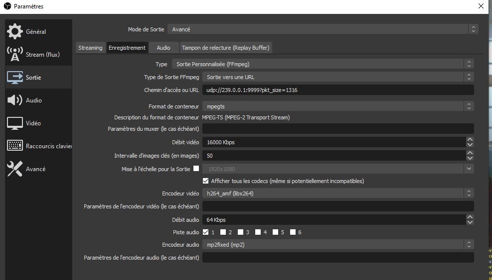

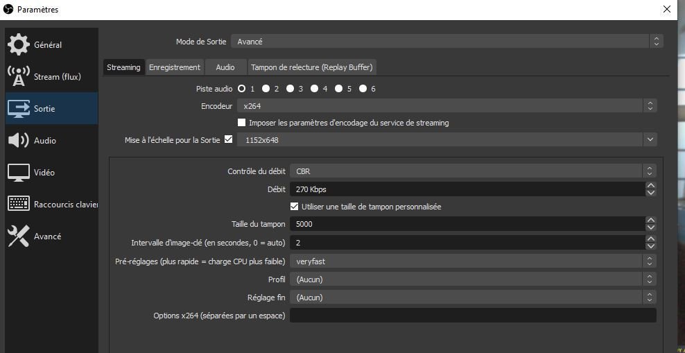

Post by F1CJN_alain » Sun Oct 27, 2019 9:17 am
This is my configuration to output the OBS UDP stream to the Jetson (333k).(Don't use the LKV373A any more)
Just switch the LKV address in the Jetson Nano file to the UDP address from the pictures below.
Note : the audio encoder "mp2fixed" is very important in order to be accepted by DVBSDR.
It is a starting point, not perfect so it can be improved ....Let us know.
Best 73's
Alain F1CJN

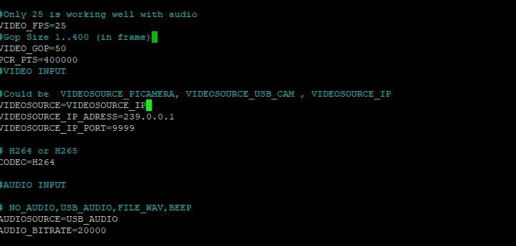

Modifying the "jetson_nano.sh" script.
If you have already a working "jetson_nano.sh" script for SR333 with the LKV373A.
It just need to switch LKV the videosource address to the new address from the OBS from my previous mail.
Just modify two lines:
VIDEOSOURCE_IP_ADRESS=239.0.0.1
VIDEOSOURCE_IP_PORT=9999

That's what I thought - unfortunately it does not work and I get continuous underflow errors.
